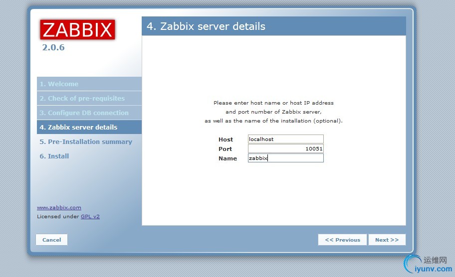

http://serverIP/zabbix
//显示报错如下信息

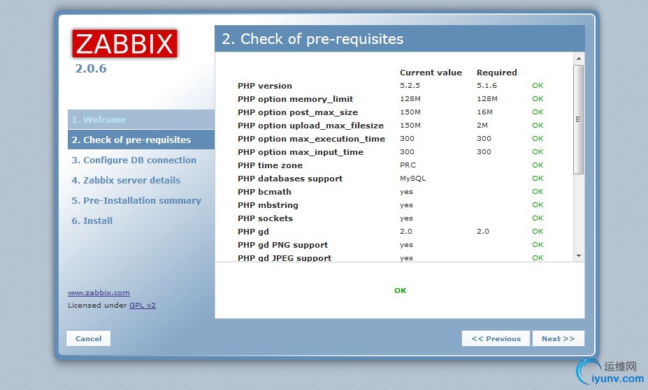

PHP option max_execution_time    30    300    Fail
PHP option max_input_time    60    300    Fail
max_execution_time = 300
max_input_time = 300
PHP bcmath    no         Fail
[iyunv@video bcmath]# cd /root/soft/php-5.2.5/ext/bcmath
[iyunv@video bcmath]# /usr/local/php/bin/phpize
Configuring for:
PHP Api Version:         20041225
Zend Module Api No:      20060613
Zend Extension Api No:   220060519
[iyunv@video bcmath]# ./configure --with-php-config=/usr/local/php/bin/php-config
[iyunv@video bcmath]# make && make install
Installing shared extensions:     /usr/local/php/lib/php/extensions/no-debug-zts-20060613/
extension_dir = "/usr/local/php/lib/php/extensions/no-debug-zts-20060613"
extension = bcmath.so
PHP mbstring    no         Fail
[iyunv@video mbstring]# cd /root/soft/php-5.2.5/ext/mbstring
[iyunv@video mbstring]# /usr/local/php/bin/phpize
Configuring for:
[iyunv@video mbstring]# ./configure --with-php-config=/usr/local/php/bin/php-config
[iyunv@video mbstring]# make && make install
extension = mbstring.so
PHP sockets    no         Fail
[iyunv@video sockets]# cd /root/soft/php-5.2.5/ext/sockets
[iyunv@video sockets]#  /usr/local/php/bin/phpize
Configuring for:
[iyunv@video sockets]# ./configure --with-php-config=/usr/local/php/bin/php-config
[iyunv@video sockets]# make && make install
extension = sockets.so
PHP gettext    no         Fail
[iyunv@video gettext]#  /usr/local/php/bin/phpize
Configuring for:
[iyunv@video gettext]# ./configure --with-php-config=/usr/local/php/bin/php-config
extension = gettext.so
PHP gd JPEG support    no         Fail
PHP gd FreeType support    no         Fail
[iyunv@video gd]#  /usr/local/php/bin/phpize
Configuring for:
[iyunv@nagiossrv gd]# ./configure --with-php-config=/usr/local/php/bin/php-config --with-jpeg-dir --with-freetype-dir
admin
zabbix
