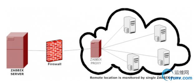

  The proxy requires only one TCP connection to the Zabbix server. This way it is easier to get around a firewall as you only need to configure one firewall rule.
  Zabbix proxy must use a separate database. Pointing it to the Zabbix server database will break the configuration.
  All data collected by the proxy is stored locally before transmitting it over to the server. This way no data is lost due to any temporary communication problems with the server. The ProxyLocalBuffer and ProxyOfflineBuffer parameters in the proxy configuration file control for how long the data are kept locally.

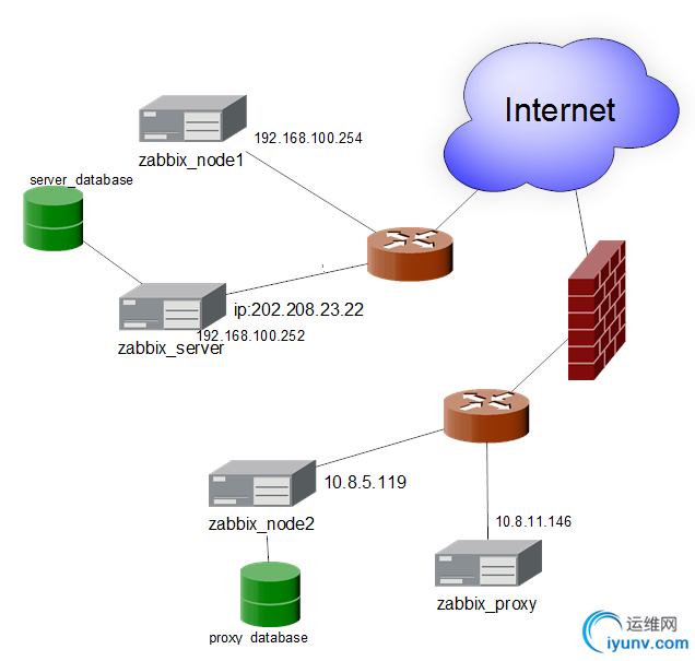

  四、网络拓扑图介绍

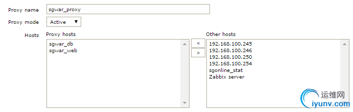

  proxy配置:【注意:这里配置的proxy name需要和zabbix_proxy.conf配置的Hostname一致;Proxy mode需要和zabbix_proxy.conf中ProxyMode一致】

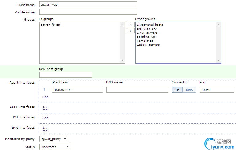

  node配置:【注意:这里配置的Host name需要和前面zabbix_agentd.conf中配置的Hostname一致;IP address需要和proxy访问node时指定的ip一致;Monitored by proxy需要指定proxy的名字】

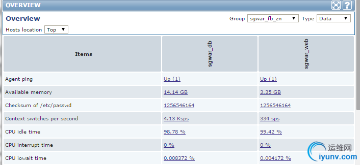

  六、前台监控结果
