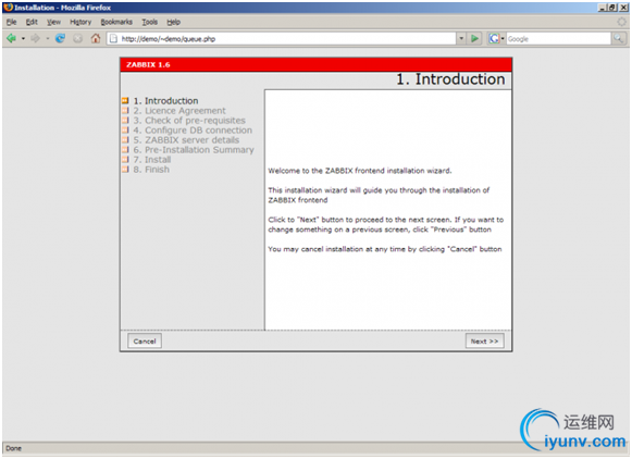

    • Open a browser under AIA VPN, input the address: http://10.50.162.39<IP address here>/zabbix/queue.php

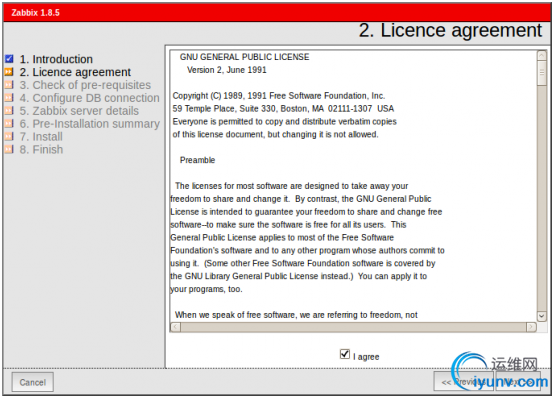

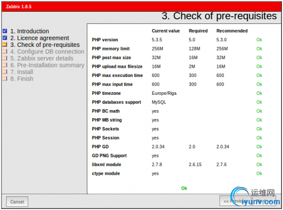

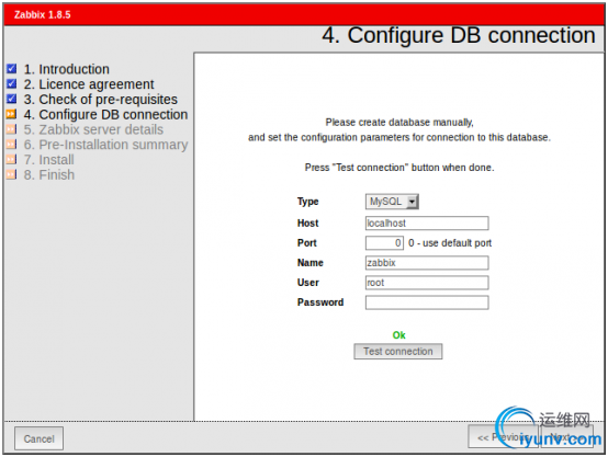

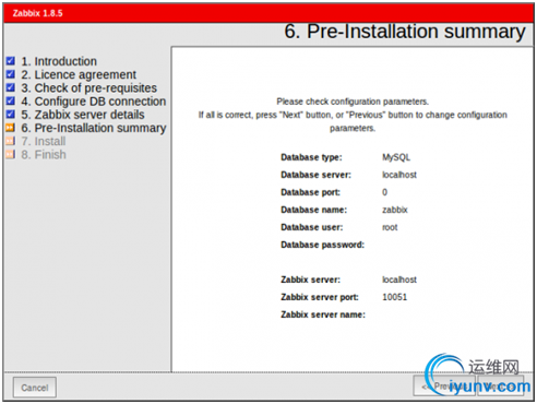

  • Configure database settings. Zabbix database must already be created.
    Please input "zabbix" in "Name", "User" and "Password" fields. DSC0005.png DSC0006.png

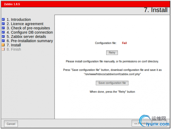

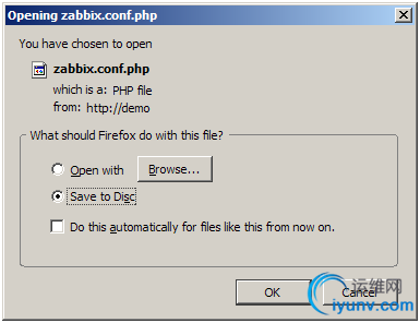

  • Download configuration file and place it under conf/. DSC0008.png

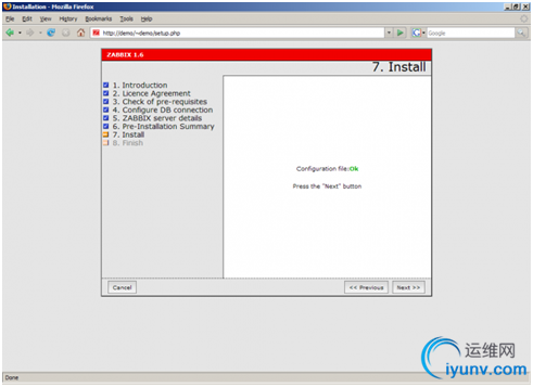

    • After saved, upload the file zabbix.conf.php to /srv/www/htdocs/zabbix/conf/
