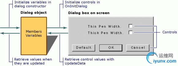

  The following figure illustrates dialog data exchange.
Dialog Data Exchange
