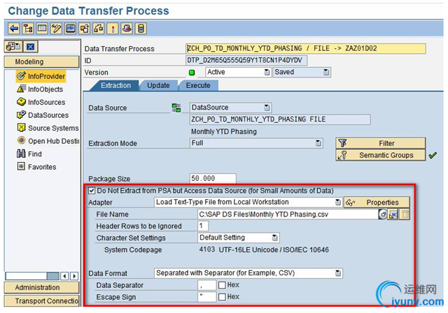

  If you are loading small amounts of master data and want to avoid using the PSA for example when you are testing things in your sandbox there is a way;  in data transfer process (DTP) maintenance, you can specify that data is not extracted from the PSA of the DataSource but is requested straight from the data source at DTP runtime. The (rather long!) Do not extract from PSA but allow direct access to data source check box is displayed for the Full extraction mode if the source of the DTP is a DataSource.
  By using this method you do-not have to create an InfoPackage to extract data from the source system.

  • Data is extracted synchronously - as in while you wait, hence it advises small data loads only, this does increase pressure on the systems memory
  • If errors occur during the data load you have to extract the data again as the PSA is not available as a buffer.
  • Deltas are not possible, only full loads.
  • In the DTP, the filter only contains fields that the DataSource allows as selection fields. If you use the PSA, you can filter by any available field.
