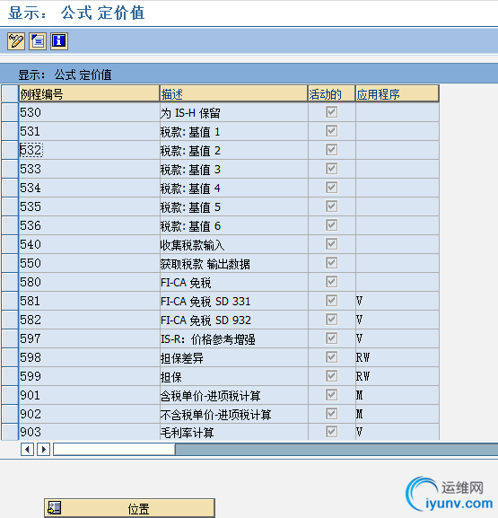

  ZM01:通过计算类型增强909算出的应交进项增值税。
  909增强代码如下表:
  *909通过含税价格计算出采购净价,反应到条件类型ZM01,注意XKOMV-KAWR表示
  *条件基价(SE11查看KOMV),即信息记录价格,比如信息记录含税价为1170/,则其中
  *价外增值税为(1170/1.17得到净价)* 17%, 909考虑不同税率情况.
  FORM FRM_KONDI_WERT_909.
  CASE KOMP-MWSKZ .
  WHEN 'J1'. "17%
  XKWERT = XKOMV-KAWRT * 17000 / 117000 * ( -1 ).
  WHEN 'J2'. "13%
  XKWERT = XKOMV-KAWRT * 13000 / 113000 * ( -1 ).
  WHEN 'J3'. " 7%
  XKWERT = XKOMV-KAWRT * 7000 / 107000 * ( -1 ).
  WHEN 'J4'. " 4%
  XKWERT = XKOMV-KAWRT * 4000 / 104000 * ( -1 ).
  WHEN 'J5'. " 5%
  XKWERT = XKOMV-KAWRT * 5000 / 105000 * ( -1 ).
  WHEN 'J6'. " 6%
  XKWERT = XKOMV-KAWRT * 6000 / 106000 * ( -1 ).
  WHEN 'J0'.
  XKWERT = 0.
  ENDCASE.
  ENDFORM.
