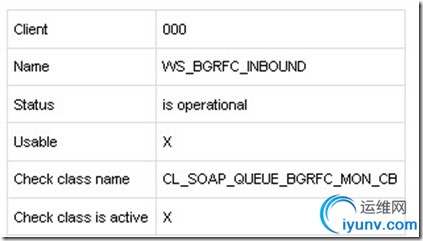

  • Inbound destination with attributes (client/tenant, name, status [soastage:operational/ not operationl], usable [soastage:true/false], name of the registered check class for the scheduler destination, status of the registration of the check class [soastage:active/inactive])
  • Example:

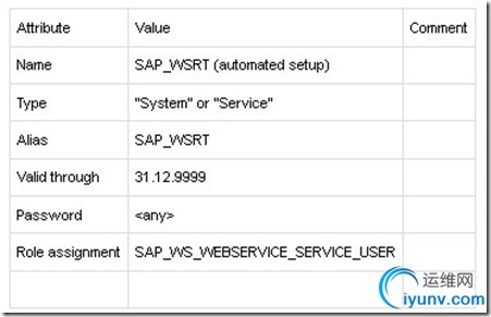

  The service user (一旦创建) 就被分配给the service destination. 它命名为SAP_WSRT. 用户的类型必须是 “System” 或者 “Service”, 在此,类型 “System” 是被推荐的, 因为类型 “Servce” 运行根据客户端进行窗口登录. 用户分配给角色SAP_BC_WEBSERVICE_SERVICE_USER. 这个角色包括所有后台运行所需的各类对象权限.
  用户属性如下:
  一旦服务用户被创建,就会分配给service destination. 服务用户的创建和分配,也是自动创建的一部分.

bgRFC的入站地址
  The Web service runtime uses the background RFC as scheduler for processing the web service messages. The bgRFC does need some settings to connect/register the web service runtime at the scheduling service. This is a) the bgRFC inbound destination and b) the scheduler destination for registration of the web service runtime check class. In Release 7.* there is only on inbound destination for each system necessary, in release 8.* for any client/tenant an inbound destination is required.
  The bgRFC inbound destination has to be registered together with five different prefixes which are used to create bgRFC queue names. These prefixes are:
  PERSC_    to build names for consumer queues for external persistent sequences
  PERSP_    to build names for provider queues for external persistent sequences
  SRTQC_   to build names for consumer queues for external transient sequences
  SRTQP_    to build names for provider queues for external transient sequences
  SRTQS_    to build names for queues for shortcut sequences
  The name of the bgRFC inbound destination and its prefix set ups are registered via transaction SBGRFCCONF. After the inbound destination nad its prefixes has been registered at the bgRFC, the name of the inbound destination has to be registered at the web service runtime properties. Call report SRT_ADMIN and put the name into field “Name of inbound destination” flag the switch “Register name og inbound destination” to ‘X’ and execute the report (F8).
  To supress the possibility to restart or delete unit’s of the web service runtime at the bgRFC Monitor (avoid inconsistencies between web service sequence handling and bgRFC queue/unit handling) register the name of the inbound destination at the bgRFC as an scheduler destination. Once added, use the class name “CL_SOAP_QUEUE_BGRFC_MON_CB” as an check class for the scheduler destination and set this name as “active”.
  These settings for inbound destination and check class registration is processed automatically, if you use the automated set up procedure by report SRT_ADMIN. bgRFC的监控地址
