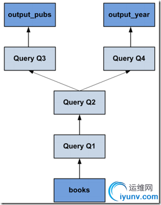

  CREATE PROCEDURE getOutput( IN cnt INTEGER, IN currency VARCHAR(3),
                            OUT output_pubs tt_publishers,
                            OUT output_year tt_year)
     LANGUAGE SQLSCRIPT READS SQL DATA AS
BEGIN
  big_pub_ids = SELECT publisher AS pid FROM books      -- Query Q1
                GROUP BY publisher HAVING COUNT(isbn) > :cnt;
  big_pub_books = SELECT title, name, publisher,        -- Query Q2
                         year, price
                  FROM :big_pub_ids, publishers, books
                  WHERE pub_id = pid AND pub_id = publisher
                  AND crcy = :currency;
  output_pubs = SELECT publisher, name,                 -- Query Q3
                       SUM(price) AS price, COUNT(title) AS cnt
                FROM :big_pub_books GROUP BY publisher, name;
  output_year = SELECT year, SUM(price) AS price,       -- Query Q4
                COUNT(title) AS cnt
                FROM :big_pub_books GROUP BY year;
END;
