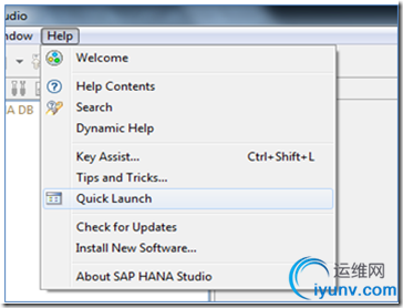

  1. Open the Quick Launch Page
  • From the Help Menu > Quick Launch
  2. Click on “Generate Time Data” under Data.

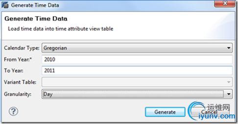

  3. Enter the following entries.
  • Select Gregorian as the Calendar Type.
  • Enter 2010 to 2011 (you can use any year)
  • Select DAY for the Granularity
  • Click Generate.

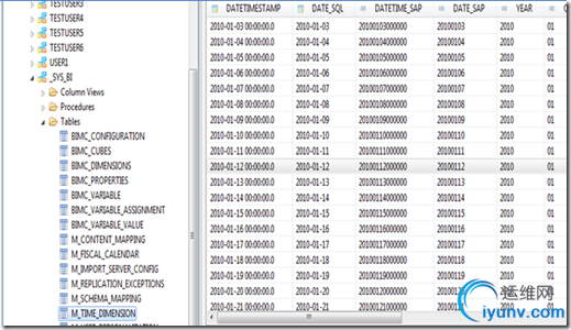

  4. Check the Generated data within the table “_SYS_BI.M_TIME_DIMENSION”. There should be an entry for every DAY between 2010 and 2011.

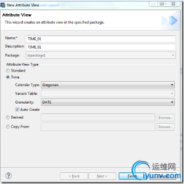

  6. Enter “TIME_01” for the name of the view
  • Select Time ->Gregorian.
  • For the Granularity select “Date”
  • Click on Auto Create.
  • Click Finish.
  7. As a result you will see the Dimensions table with the generated Attributes. Optionally you can remove any attribute fields that are not needed.

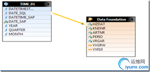

  14.  Open the Logical View. Click on the tab ‘Logical View’ at the bottom of the detail screen.
  • Drag TIME_01 attribute view in Window.
  • Create a Referential (n ..1) Join between TIME_00.DATE_SQL and Data Foundation HZDAT field.

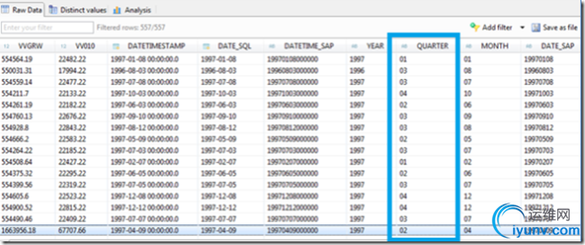

  15. Activate & Preview.
