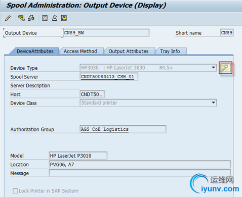

  Most of the steps could be found here. Basically you need to start with creating an output device (the printer you selected when you trigger printing in SAP system).
  Then switch to change mode and choose “Create” to create a new printer in the SAP system.

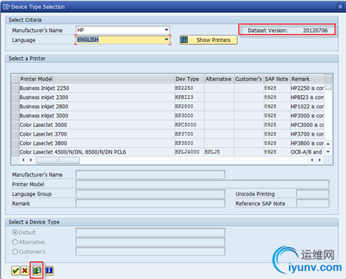

  The device type is the printer’s type and the if the information is not maintained in the system, there is a wizard to help on the device type information. Note 1036961 provides how to get this information updated.

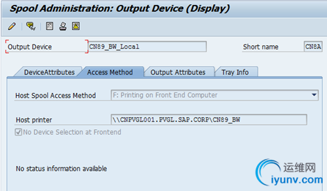

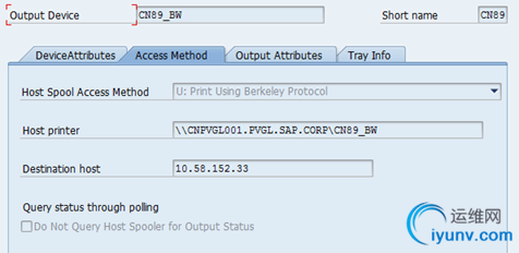

  In the Access Method tab, you can maintain how the printer could triggered. And there are mainly two different ways.
  Method 1 – Print remotely via network printer.
  If you don’t maintain the printer locally on the client device, the system admin should be responsible to maintain the related server information.
  Method 2 – Print locally with the printer on your laptop.
  In this way normally you could maintain the Host Printer as “__Default” so that the default printer on each client device could be matched. Here I maintain it as one of our office printer and that should work from most of my colleagues. So there is also no issue about the Host Printer name. However, if there is no proper printer maintained for other clients, spool requests using this printer will fail.
