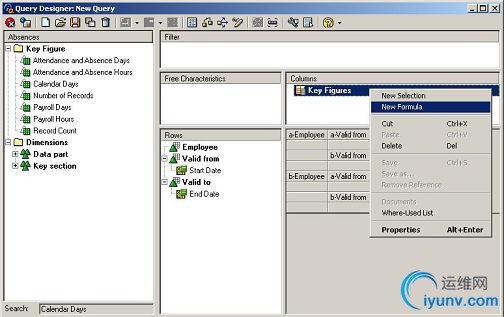

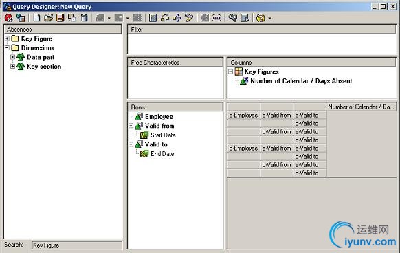

  • Open the BEx Query Designer and create a new report on your chosen InfoProvider.
  • Drag the Employee, Valid from and Valid to characteristics into the Rows section of the screen. If needed, apply data selection restrictions to the characteristics as shown in Figure 1.
  • Right click on the Key Figures structure and select New Formula (Figure 1).
    DSC0000.jpg Figure 1

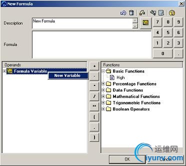

  • In the new formula window right click on Formula Variable and choose New Variable ( Figure 2 ).

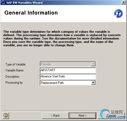

  • Enter the variable details on the General Information as shown in Figure 3 .
    Enter the Variable Name , Description and select Replacement Path in the Processing by field.
    Click the Next Button.
    DSC0002.jpg Figure 3

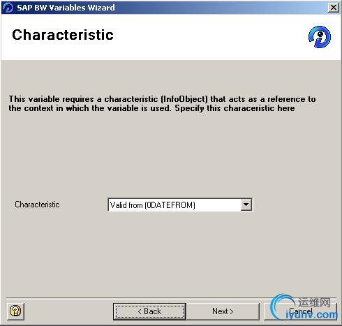

  • In the Characteristic screen (Figure 4) select the date characteristic that represents the first date to use in the calculation (From Date).

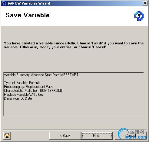

  • The Save Variable screen (Figure 7) displays a summary of the new variable.
    Click on the Finish button to save the variable.
    DSC0006.jpg Figure 7

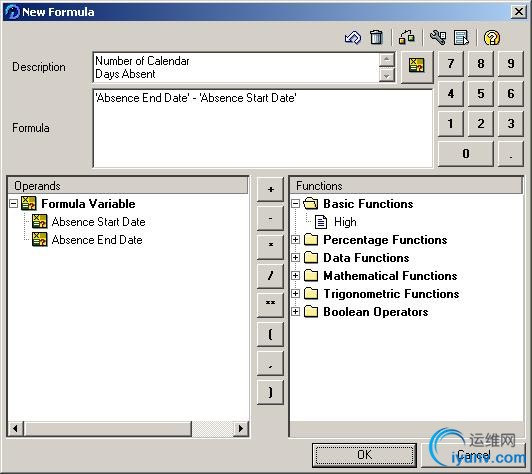

  • You will now be back at the New Formula screen (Figure 8). Drag and drop the two new variables into the formula section of the screen and insert the subtract sign (“-“) between the two.
  • Give the new formula a description and click the formula syntax check button DSC0007.jpg to ensure the formula is valid.
    DSC0008.jpg Figure 8
