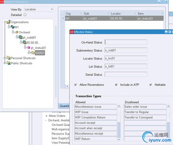

  An example of onhand in the material workbench showing status

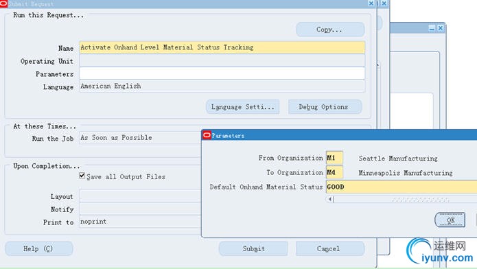

  Activate On-hand Level Material Status Tracking for one organization, Run concurrent request ‘ActivateOnhand Level Material Status Tracking’
  NOTE: Once an organization is activated as onhand status tracked itcannot be reverted back. If you have accidentally Run Activate On-Hand Material Status, Please refer to Note1198443.1, The following Enhancement Request was logged suggesting that users should be allowed to deactivate the status:  Bug8626159 - ER to allow de-activate: Allow user to deactivate / de-activate 12.1 Feature: On-hand Status Tracking

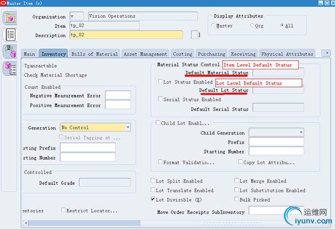

  If user does not set a default status at Item level or Lot level, onhand status will pick locator levelstatus as default onhand status.
  There is priority order for onhand status picking, and like following…
  Item Status/Lot status > Locator Status > Sub status > Org status
  For lot controlled item, it can only set ‘Default Lot Status’, can NOT set ‘Default Material Status’.For plain item, it can only set ‘Default Material Status’, can NOT set ‘Default Lot Status’. So for a item, it’s impossible that item has item level status as well as has lot level status.

  Cumulative Allowed/Disallowed Txn type
  A example, Misc receipt item into sub:pt_subb01, locator:55.55.55.., lot number:S00567
  Subinv Status: s_sub01, It disallow transaction type: Sales Order issue
  Locator Status:s_loc01, It disallow transaction type: Transfer to Consigned
  Lot Status: s_lot01, It disallow transaction type: Transfer to Regular
  So for the item, it will disallow all above three transaction types.
