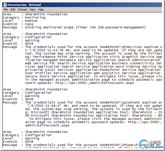

  Finally if you would want these messages to be put into a text or log file instead, you could just add the classic “> C:Awesome.log” after the command like this:
  get-splogevent | ?{$_.Correlation -eq "<GUID>"} | select Area, Category, Level, EventID, Message | Format-List > C:Awesome.log

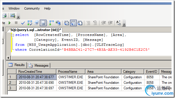

  You can utilize the SQL logs database to fetch the specific error message based on Correlation id as well. In your logging DB (usually called WSS_Logging, but can be called something else if you’ve changed it) there is a view called ULSTraceLog which you can query with a simple SQL query and fetch the results.
  I’ve created a query to fetch the items from the logging database like this:
select [RowCreatedTime],  [ProcessName],  [Area],
[Category],  EventID,  [Message]
from  [WSS_UsageApplication].[dbo].[ULSTraceLog]
where  CorrelationId=< pre>'B4BBAC41-27C7-4B3A-AE33-4192B6C1E2C5'
  This will render your results in the SQL Query window like this:
