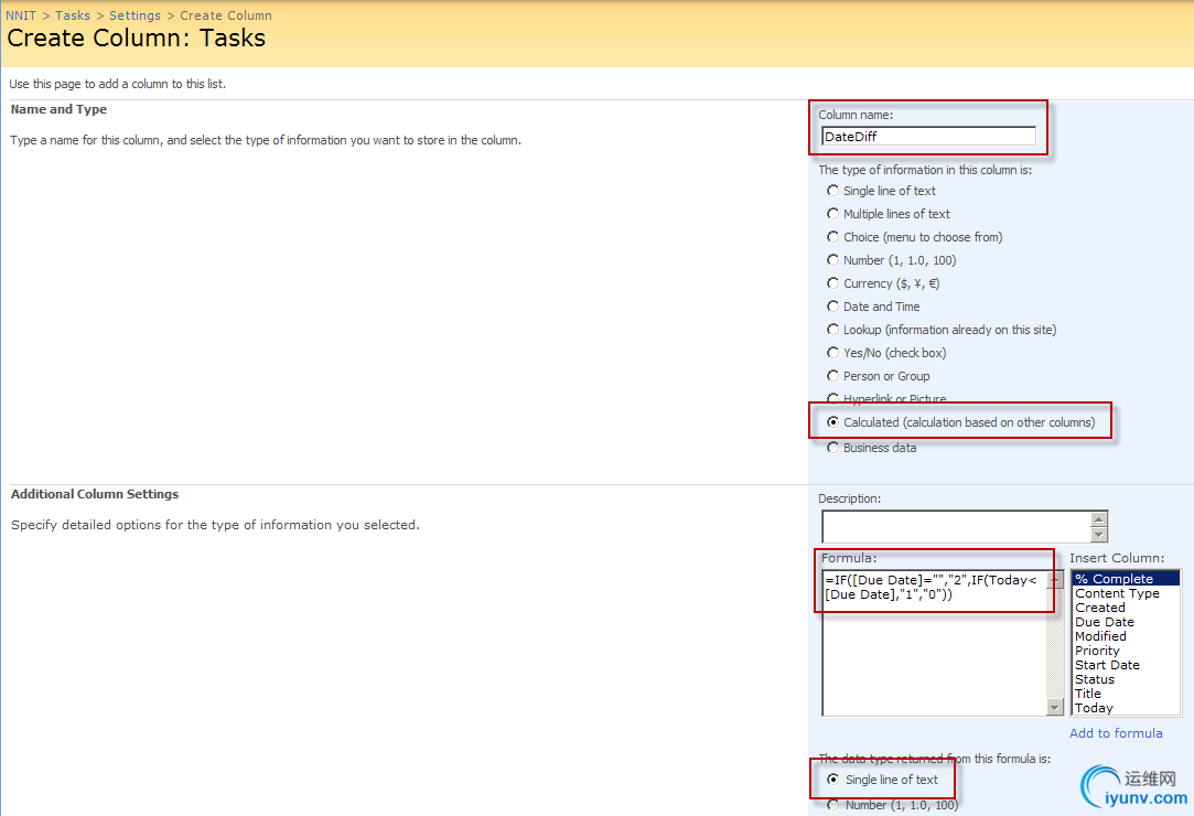

  2 Create the first Calculated Column and named "DateDiff".
  3 Input formula: =IF([Due Date]="";"2";IF(Today<[Due Date];"1";"0")).
  "0" : Today >= Due Date
  "1" : Today < Due Date
  "2" : Due Date = ""
  4 Select "Single line of text" of "The data type returned from this formula is".
  5 Upload icons to the picture library which we want to use.

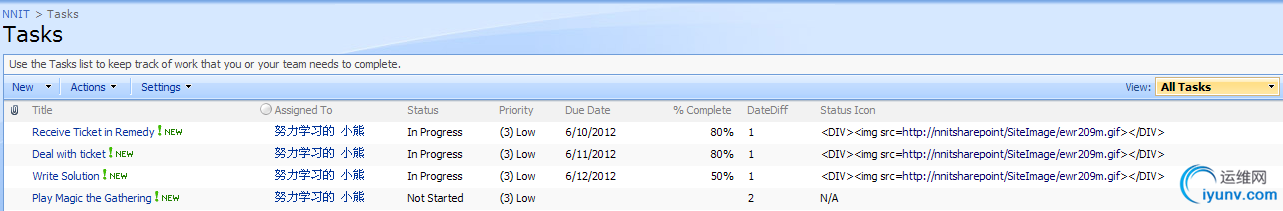

  7 We will get this result of this list.

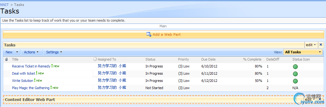

  9 We will see the result like this.

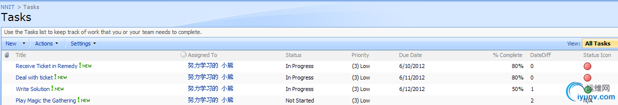

  10 Delete the Today column. We get the correct result.
