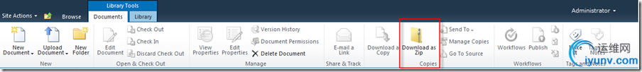

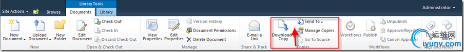

  After creating the application page, I added a SharePoint 2010 Empty Element item called DownloadZip to my project. This is nothing more than an Elements.xml file that takes care of adding my custom action to ribbon (CustomAction.Location=&#8221;CommandUI.Ribbon&#8221;). By default, for document libraries, this is what the ribbon looks like:
  I wanted to add my action inside of the area in the Documents tab, inside of the Copies group so to do this, for the CommandUIDefinition, I set the Location attribute to "Ribbon.Documents.Copies.Controls._children&#8221;. I also wanted it to appear right after the Download a Copy action so for the Button element&#8217;s Sequence attribute, I set the value to 15 (the Download a Copy button has a sequence of 10 and the Send To button has a sequence of 20 so I needed to set the sequence of my button to something in between). To understand where everything is placed and what the sequences are by default, you need to look at the file C:\Program Files\Common Files\Microsoft Shared\Web Server Extensions\14\TEMPLATE\GLOBAL\XML\CMDUI.xml. I also specified the icons I wanted to use for my action (these icons are also part of my project, located in a sub-directory of the Images SharePoint mapped folder) and I also set the TemplateAlias to &#8220;o1&#8221; so that my icon shows up large like Download a Copy does. I also define the actual command handler in this Elements.xml file by adding a CommandUIHandler element. The CommandAction attribute is used to specify what exactly the button is supposed to do and the EnabledScript attribute is used to determine whether or not the button/command is enabled. These two attributes&#8217; values both point to javascript functions I define in a separate file (discussed later). Because I&#8217;m using a separate javascript file, I also have to add another CustomAction element in the Elements file that points to the location of my javascript file. This is the result:
  Enabled
  Disabled
  Below is the full Elements.xml file:
  Elements.xml
代码
<?xml version="1.0" encoding="utf-8"?>
<Elements xmlns="http://schemas.microsoft.com/sharepoint/">
  <CustomAction Id="DeviantPoint.DownloadZip" Location="CommandUI.Ribbon">
    <CommandUIExtension>
      <CommandUIDefinitions>
        <CommandUIDefinition Location="Ribbon.Documents.Copies.Controls._children">
          <Button Id="Ribbon.Documents.Copies.DownloadZip"     Command="DownloadZip"     Sequence="15"    Image16by16="/_layouts/images/DeviantPoint.DownloadZip/zip_16x16.png"
                  Image32by32="/_layouts/images/SPMultipleFileDownLoad/zip.png"
                  Description="Download zip" LabelText="Download as Zip"
                  TemplateAlias="o1"/>
        </CommandUIDefinition>
      </CommandUIDefinitions>
      <CommandUIHandlers>
        <CommandUIHandler   Command="DownloadZip"   CommandAction="javascript:downloadZip();"   EnabledScript="javascript:enable();"/>
      </CommandUIHandlers>
    </CommandUIExtension>
  </CustomAction>

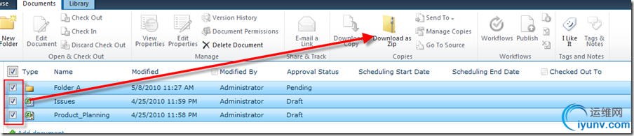

  So how does this actually all look when the user is using it? Below is the hierarchy of an example document library I have:
  • Documents
    • Folder A (Folder)
      • Subfolder in Folder A (Folder)
        • Sub Sub Folder (Folder)
          • Versioning Flow (Visio diagram)
        • Business Brief_SoW (Word document)
        • SoW_Phase1 (Word document)
      • Request Email (Text file)
      • Users and Roles (Excel file)
    • Issues (Excel file)
    • Product_Planning (Excel file)

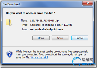

  The user has selected some documents and a sub-folder so my custom ribbon button is enabled:
  The user clicks on this button and this feature executes and after it&#8217;s complete the user is prompted with this (note, the filename is a timestamp):
