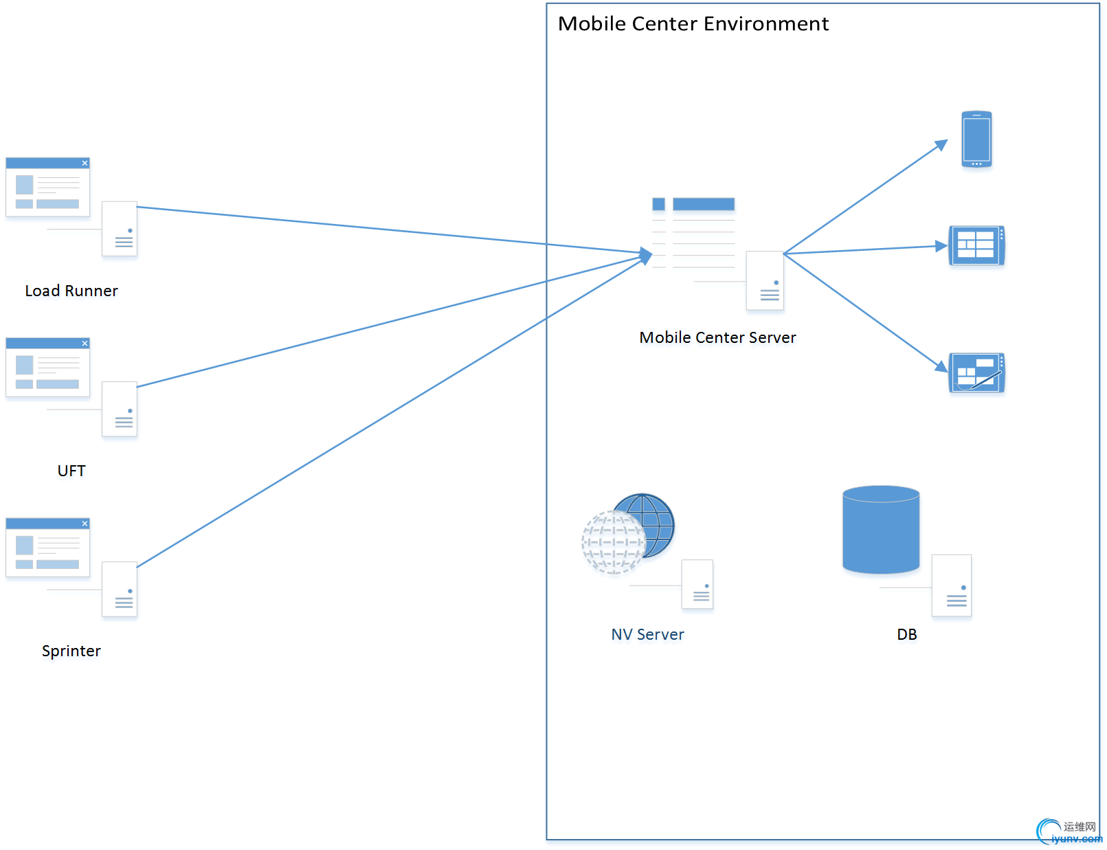

  HP Mobile Center is a standalone server that provides mobile device access to different test applications. HP Mobile Center supports a distributed architecture where different test clients can all interact with the same Mobile Center server instance.
  The HP Mobile Center environment is made up of the following components:
  · The Mobile Center server
  · Test devices that are connected to the Mobile Center server
  · A database server, which by default is run on the Mobile Center server itself
  · An optional network virtualization server which can be used to test applications running under different network conditions
The following diagram shows the relationship between these components and the different clients:

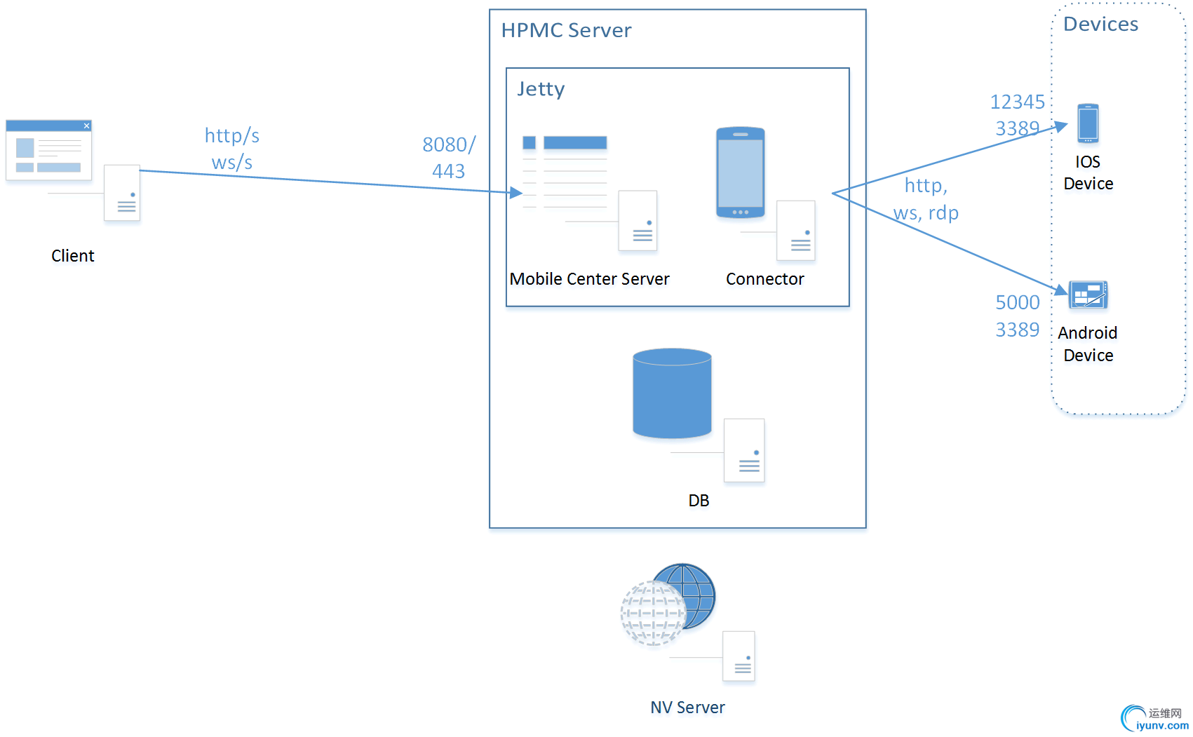

  The next diagram shows a more drilled-down view, with a focus on the physical deployment of an HP Mobile Center server. The different protocols that run over the various links, and the different ports used by those channels are also shown.

  The following ports are required:
  Server:
  HTTP(8080)
  Connector:
  HTTP(8080)
  Devices:
RDP
  Androidspecific
  iOSspecific
3389
  5000
  5001
  12345
