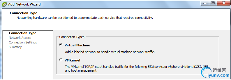

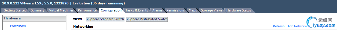

  (1). Click "Configuration" item on ESXI with the vsphereclient
  (2). Click "Add networking", Choose "Virtual machine" , then "Next"

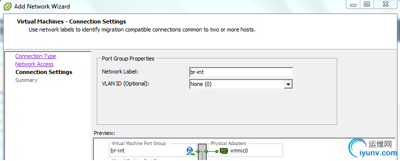

  (3). Create or choose the default switch , then "Next"
  (5). Fill the "Port group properties"
