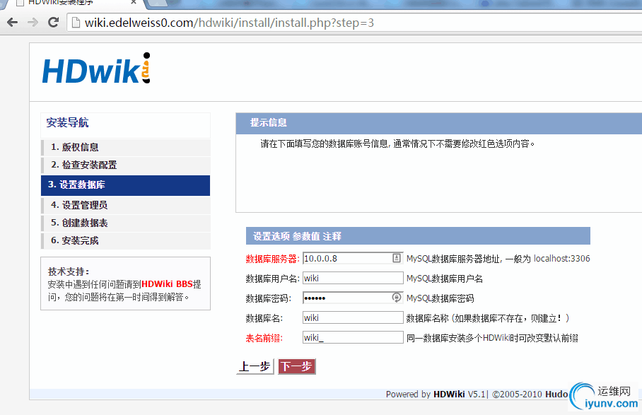

3.4为站点提供数据库和用户
9
10
11
12
13
14
mysql> drop database test;   #删除无用的数据库
Query OK, 0 rows affected (0.06 sec)
mysql> delete from mysql.user where user='';  #删除无用的用户
Query OK, 2 rows affected (0.10 sec)
mysql> create database wiki;   #创建wiki数据库
Query OK, 1 row affected (0.00 sec)
mysql> grant all on wiki.* to 'wiki'@'10.0.0.%' identified by '123456';   #创建并授权wiki数据的用户
Query OK, 0 rows affected (0.05 sec)
mysql> flush privileges;  #刷新权限

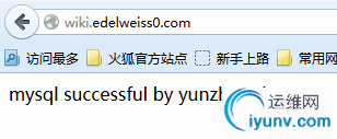

4.1测试Nginx和PHP
mkdir html/wiki
vim html/wiki/index.php
<?php
       phpinfo();
4.2测试PHP和MySQL
9
10
11
#注意防火墙的配置
vim /usr/local/nginx/html/wiki/index.php
<?php
       $link_id=mysql_connect('192.168.198.130','wiki','123456') or mysql_error();
       if($link_id){
              echo "mysql successful by yunzhonghe !";
       }else{
              echo mysql_error();

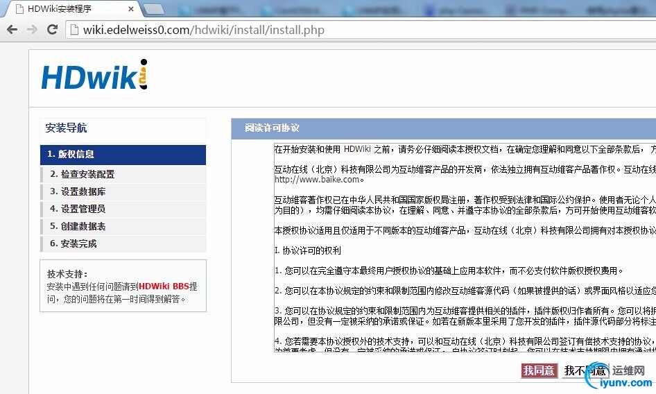

4.3建站
cd /tools/
unzip HDWiki-v5.1UTF8-20141205.zip
mv HDWiki-v5.1UTF8-20121102/* /usr/local/nginx/html/wiki/
chown nginx.nginx -R /usr/local/nginx/

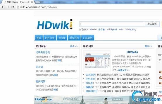

#结果展示
到时候可以自行扩展
