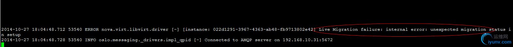

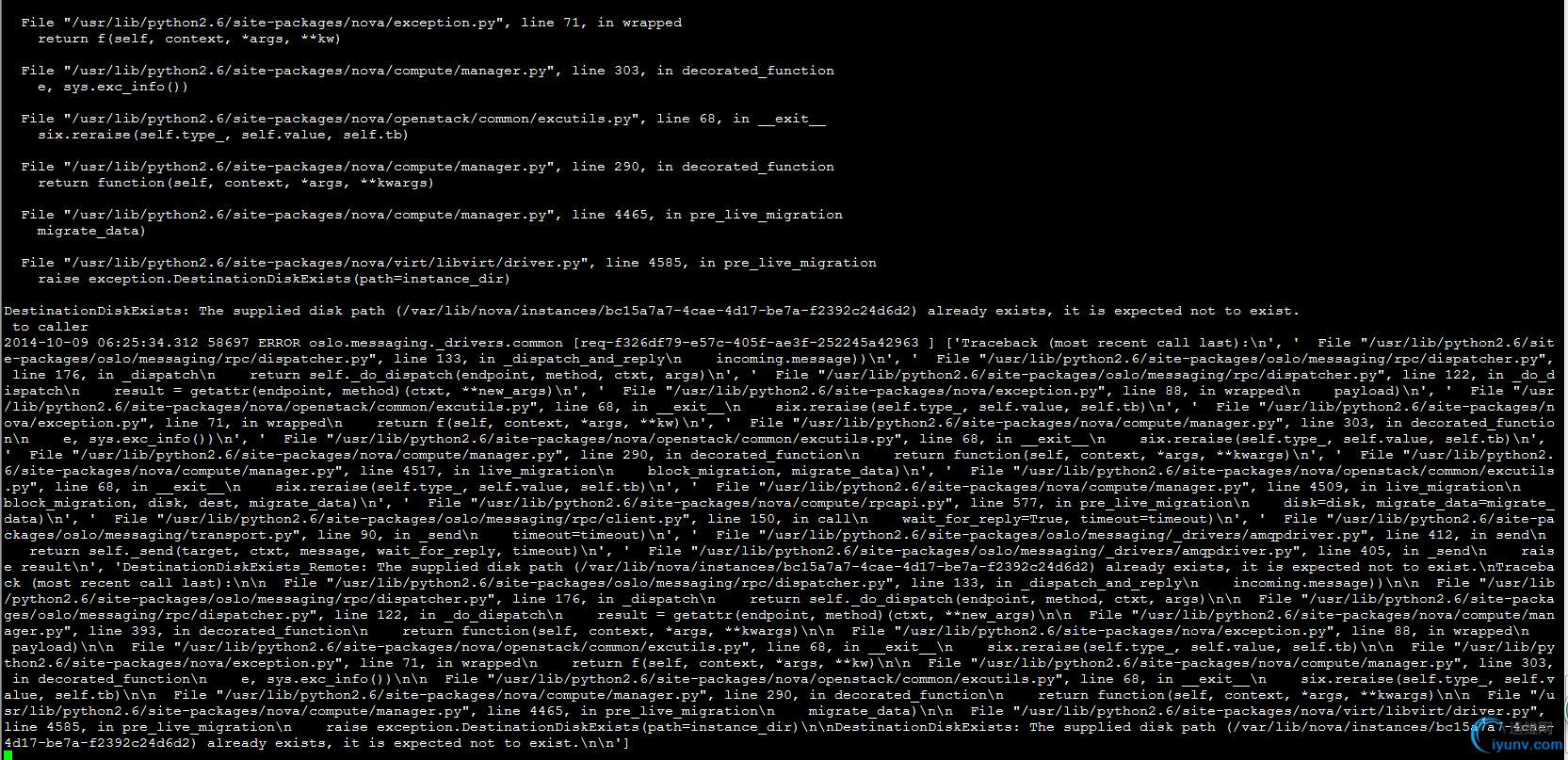

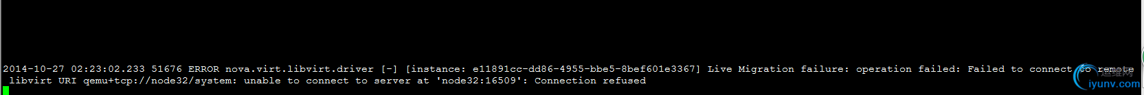

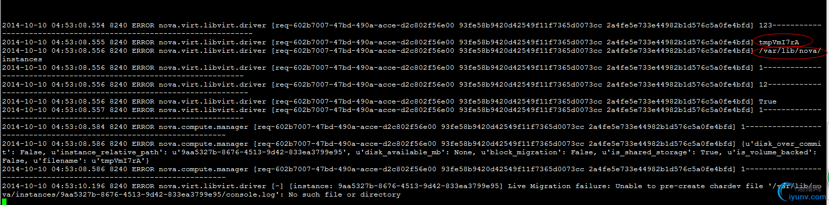

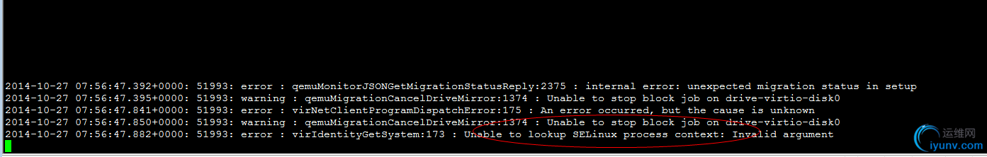

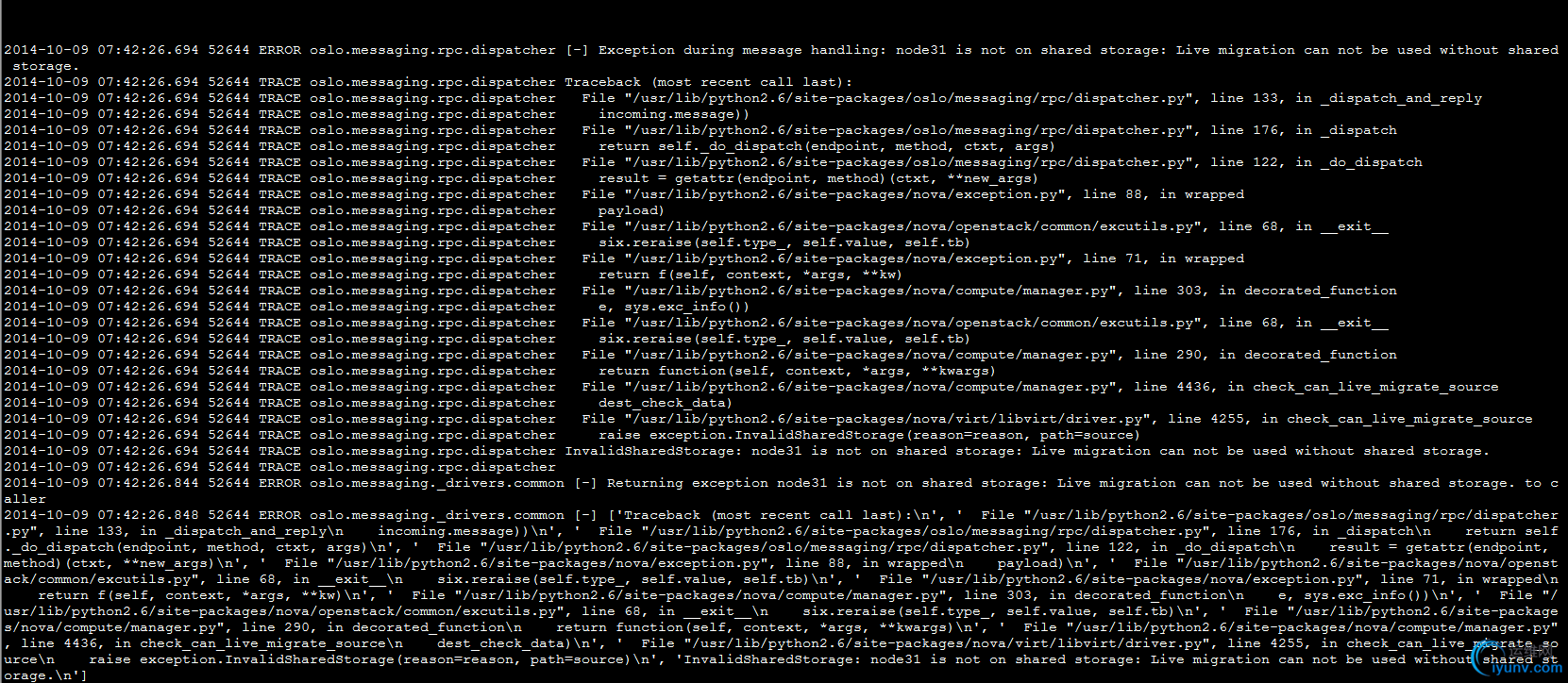

附上报错信息:

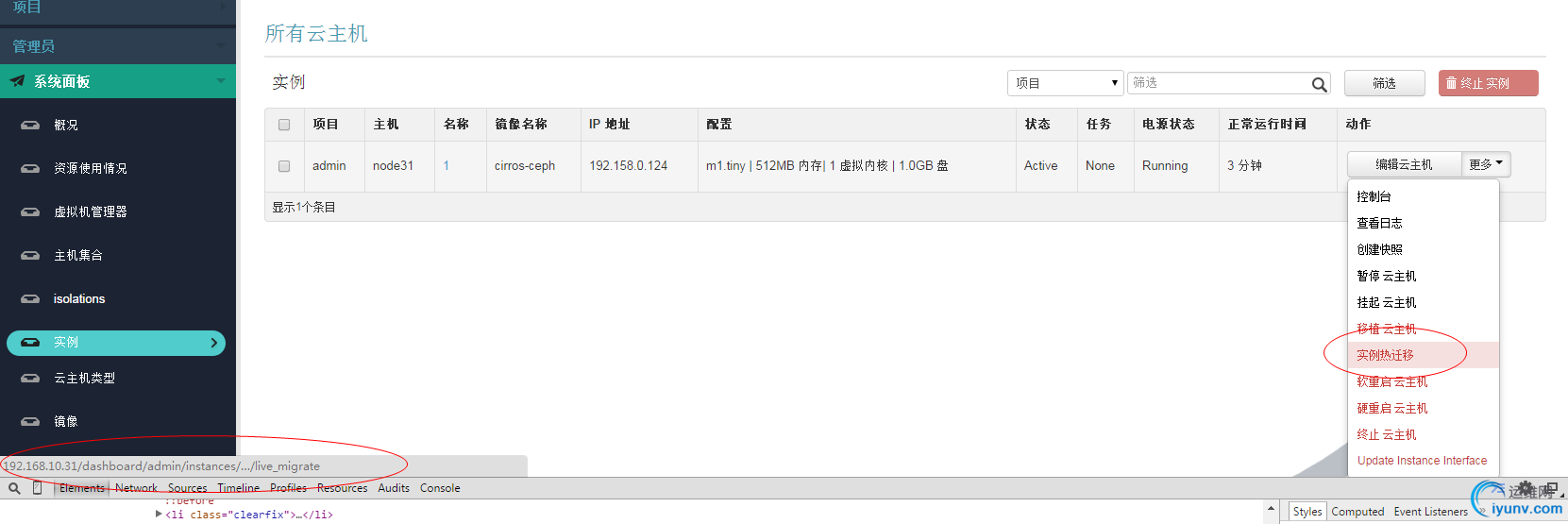

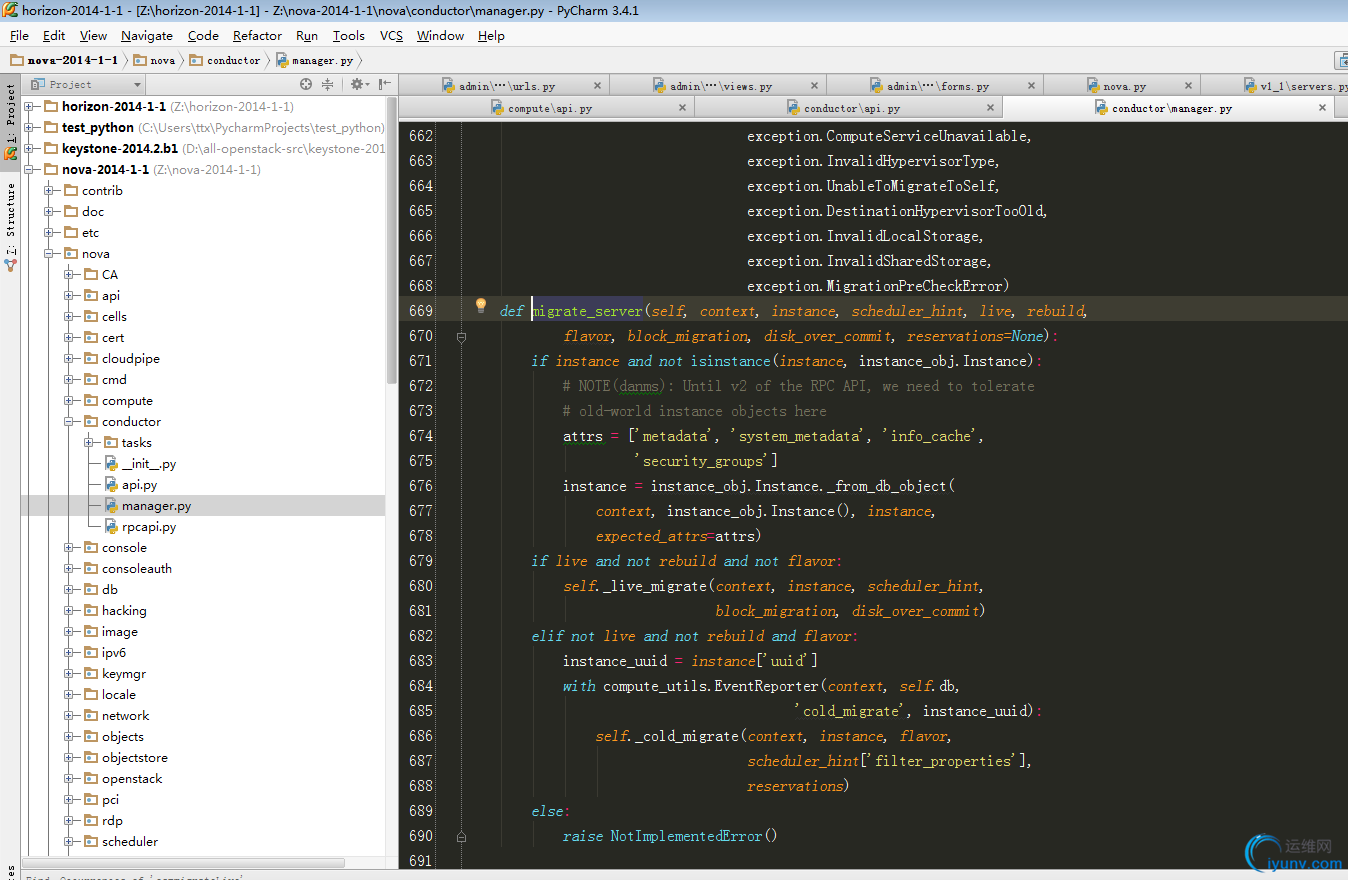

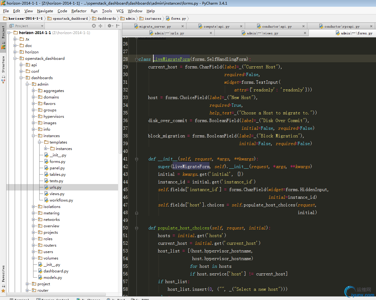

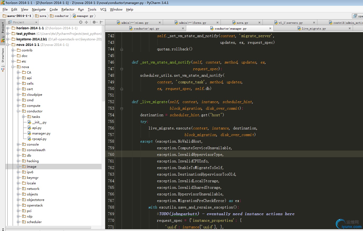

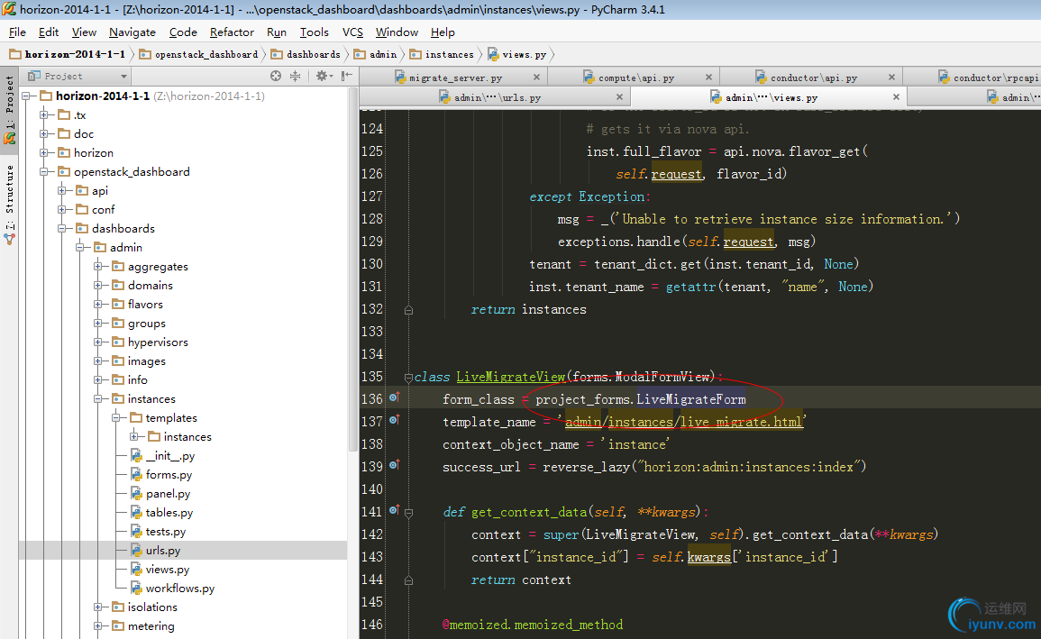

附上代码:判断冷迁移还是热迁移逻辑:
        if live and not rebuild and not flavor:
            self._live_migrate(context, instance, scheduler_hint,
                               block_migration, disk_over_commit)
        elif not live and not rebuild and flavor:
            instance_uuid = instance['uuid']
            with compute_utils.EventReporter(context, self.db,
                                         'cold_migrate', instance_uuid):
                self._cold_migrate(context, instance, flavor,
                                   scheduler_hint['filter_properties'],
                                   reservations)

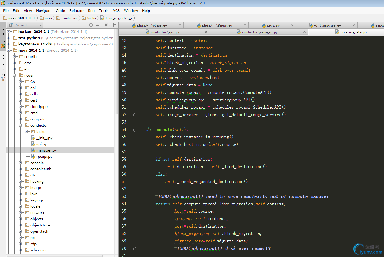

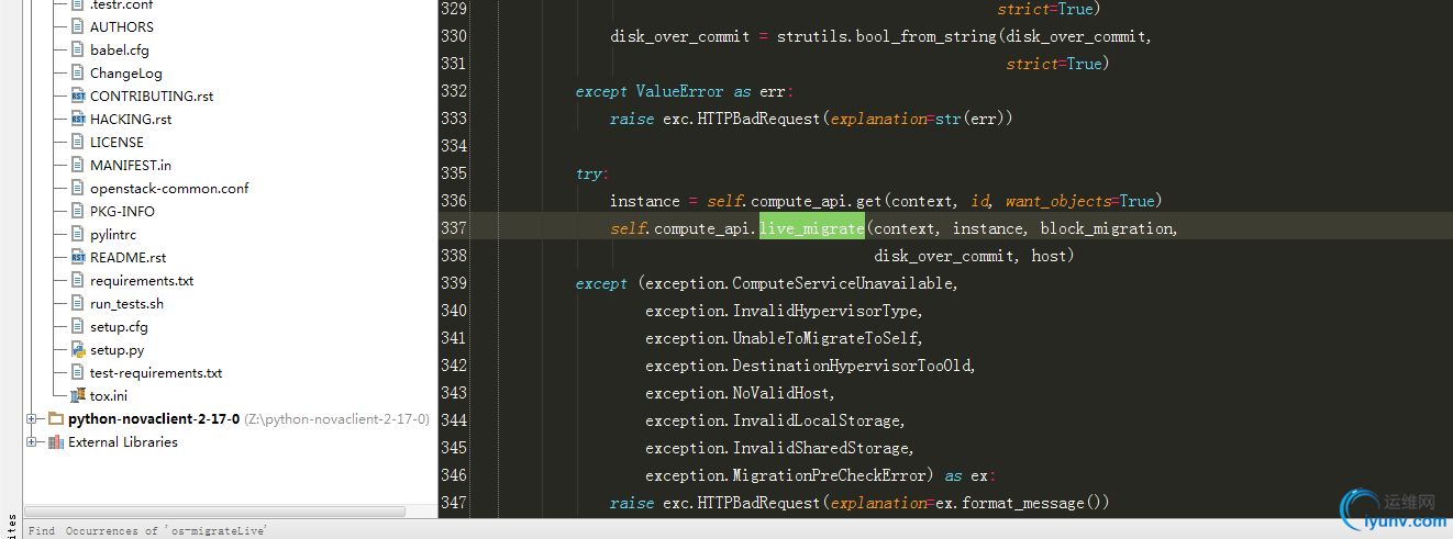

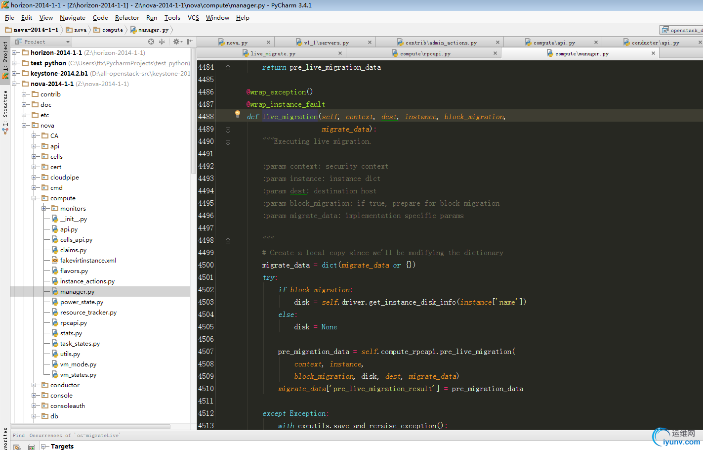

conductor调用conpute的代码:

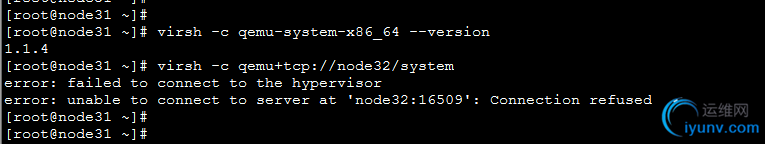

virsh -c qemu+tcp://node32/system
http://www.chenyudong.com/archives/libvirt-connect-to-libvirtd-with-tcp-qemu.html
virsh使用qemu+tcp访问远程libvirtd
http://libvirt.org/remote.html#Remote_libvirtd_configuration

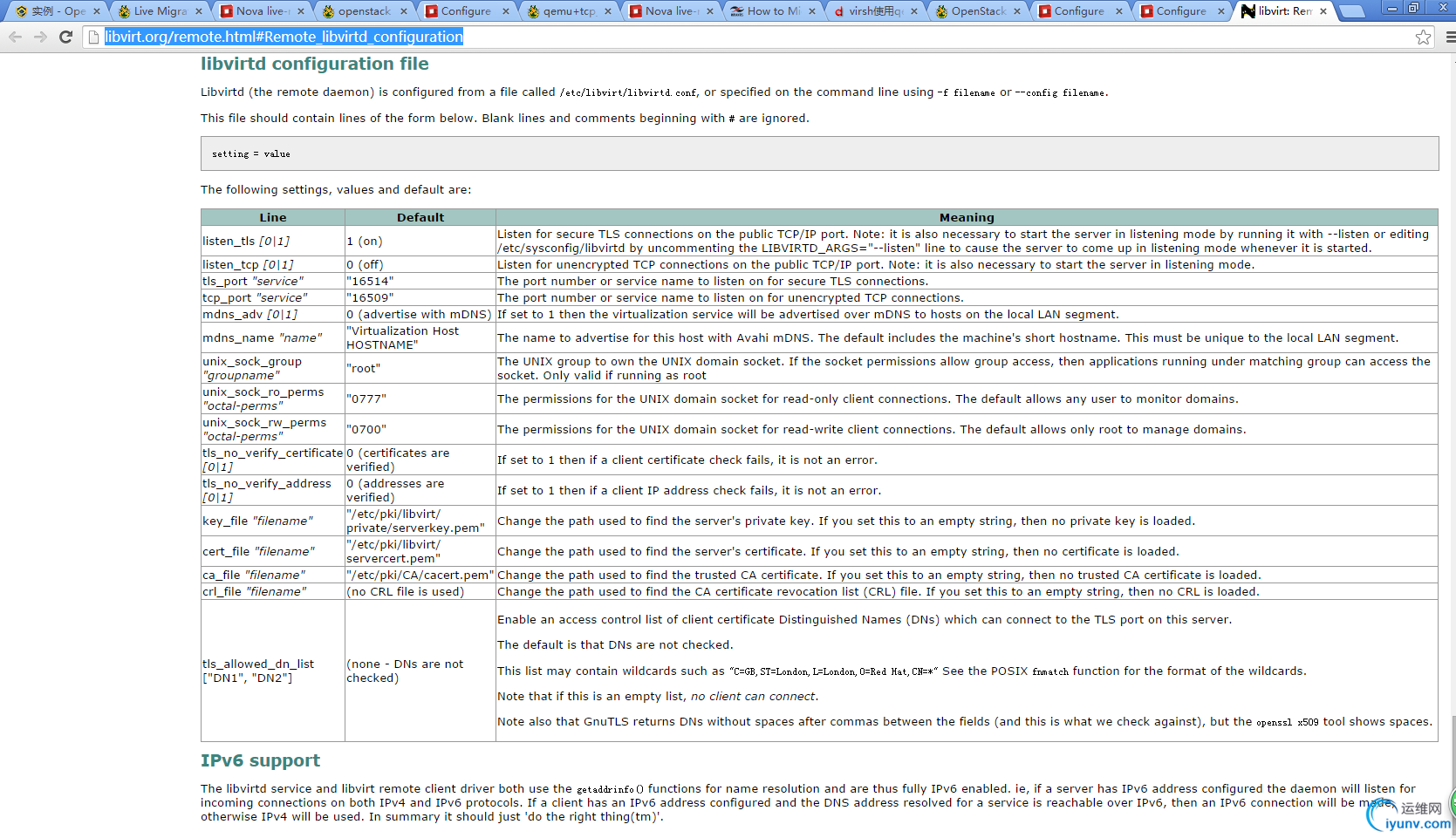

配置libvirt的监听端口:
修改文件
vim /usr/local/libvirt/etc/sysconfig/libvirtd
用来启用tcp的端口(本环境中由于libvirt升级过,配置文件目录不一致,默认为/etc/sysconfig/libvirtd
LIBVIRTD_CONFIG=/usr/local/libvirt/etc/libvirt/libvirtd.conf
LIBVIRTD_ARGS="--listen"
修改文件
vim /usr/local/libvirt/etc/libvirt/libvirtd.conf
9
listen_tls = 0
listen_tcp = 1
tcp_port = "16509"
listen_addr = "0.0.0.0"
auth_tcp = "none"
运行 libvirtd
service libvirtd restart

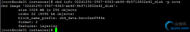

报secret错误,则将每个计算节点的uuid设置为一样:
rbd_secret_uuid=c245e1ef-d340-4d02-9dcf-fd091cd1fe47

发现两个key不一致,因此ceph的key配置有问题
重新配置正确的key值,保证所有计算节点key值相同。重新配置后,需要将之前创建的虚拟机删除,重新生成

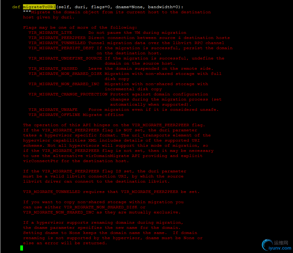

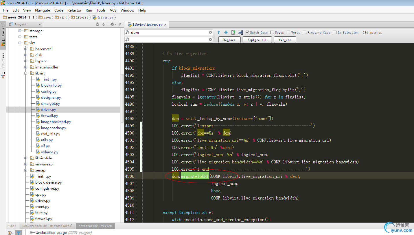

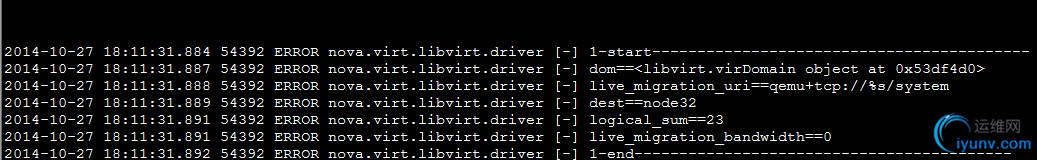

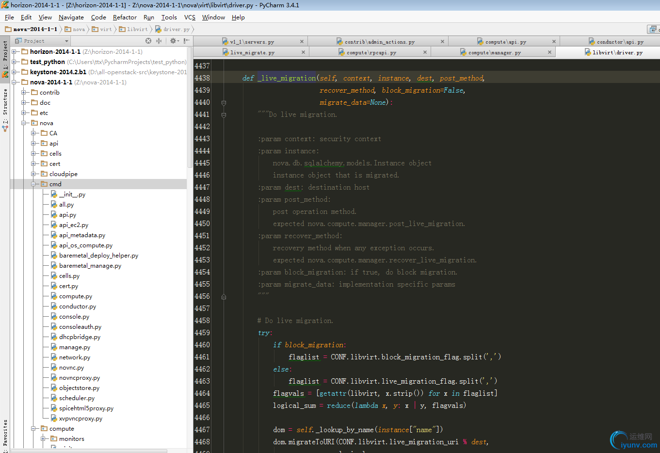

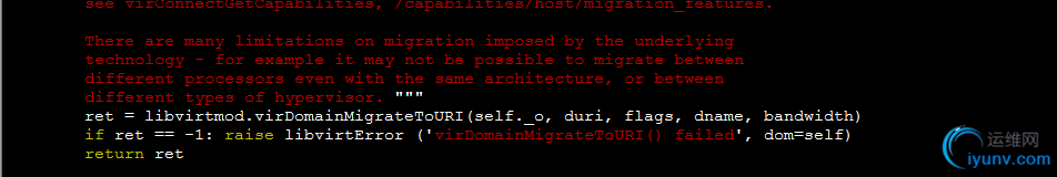

错误报在migrateToURI函数,打印输出参数:
vim /usr/lib/python2.6/site-packages/nova/virt/libvirt/driver.py
def _live_migration(self, context, instance, dest, post_method,
                        recover_method, block_migration=False,
                        migrate_data=None):
        """Do live migration.
        :param context: security context
        :param instance:
            nova.db.sqlalchemy.models.Instance object
            instance object that is migrated.
        :param dest: destination host
        :param post_method:
            post operation method.
            expected nova.compute.manager.post_live_migration.
        :param recover_method:
            recovery method when any exception occurs.
            expected nova.compute.manager.recover_live_migration.
        :param block_migration: if true, do block migration.
        :param migrate_data: implementation specific params
        # Do live migration.
        try:
            if block_migration:
                flaglist = CONF.libvirt.block_migration_flag.split(',')
            else:
                flaglist = CONF.libvirt.live_migration_flag.split(',')
            flagvals = [getattr(libvirt, x.strip()) for x in flaglist]
            logical_sum = reduce(lambda x, y: x | y, flagvals)
            dom = self._lookup_by_name(instance["name"])
            LOG.error('1-start------------------------------------------')
            LOG.error('dom==%s' % dom)
            LOG.error('live_migration_uri==%s' % CONF.libvirt.live_migration_uri)
            LOG.error('dest==%s' %dest)
            LOG.error('logical_sum==%s' % logical_sum)
            LOG.error('live_migration_bandwidth==%s' % CONF.libvirt.live_migration_bandwidth)
            LOG.error('1-end------------------------------------------')
            dom.migrateToURI(CONF.libvirt.live_migration_uri % dest,
                             logical_sum,
                             None,
        except Exception as e:
            with excutils.save_and_reraise_exception():
                LOG.error(_("Live Migration failure: %s"), e,
                          instance=instance)
                recover_method(context, instance, dest, block_migration)

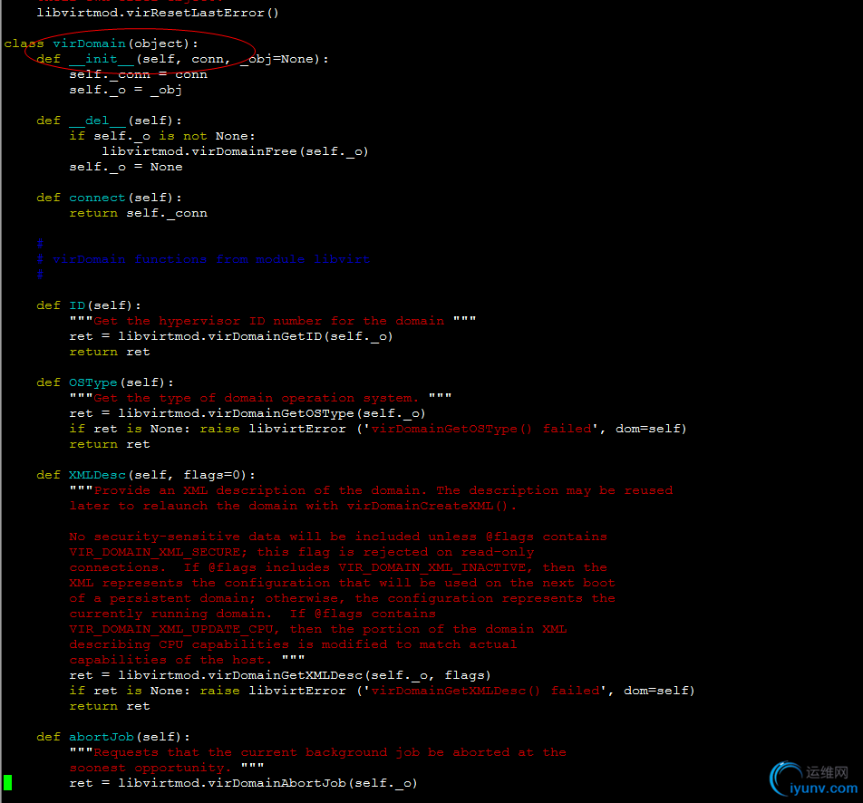

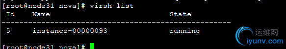

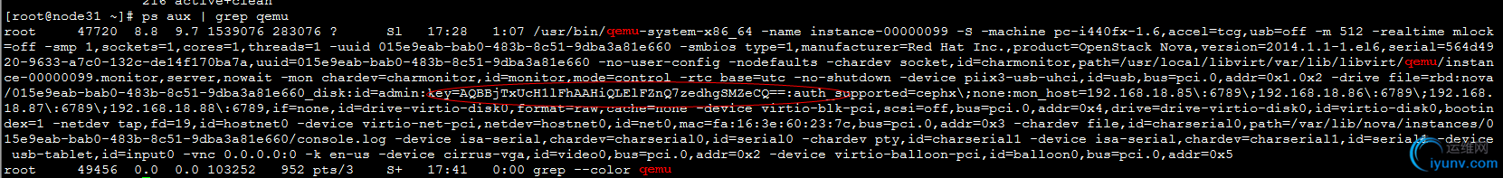

查看下虚拟机实例在node31情况:
从上述打印日志可以看出dom值为libvirt.virtDomain对象:
/usr/lib64/python2.6/site-packages/libvirt.py

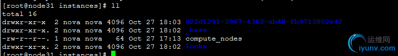

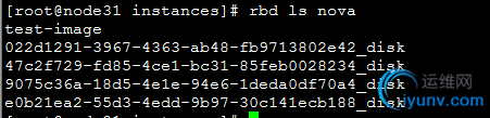

再迁移目标主机上建立文件夹:
mkdir /var/lib/nova/instances/022d1291-3967-4363-ab48-fb9713802e42/

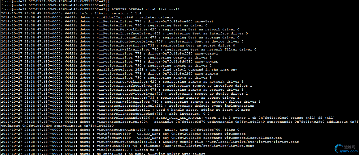

libvirt debug模式:
LIBVIRT_DEBUG=1 virsh list --all

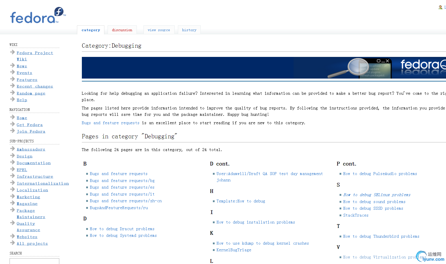

调试方法汇总:
http://fedoraproject.org/wiki/Category:Debugging

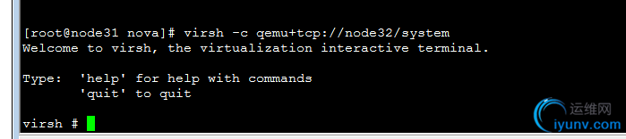

在node31上面:
http://libvirt.org/migration.html

1、hostname的配置不正确,或者DNS不正确,如果主机的hostname不能正确的解析到IP地址的化就会生成一个错误的URI,这刚好时文章开头出现的问题。此时需要明确指定IP地址或者使用正确的hostname。
2、主机有多个网络接口,此时需要用IP明确指定来关联某个具体的网卡。
3、防火墙限制端口的使用,当libvirt自动生扯功能的端口需要防火墙对其端口是开放的。

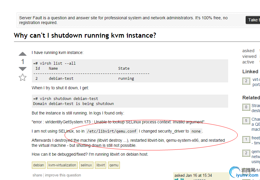

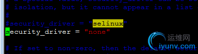

vim /usr/local/libvirt/etc/libvirt/qemu.conf

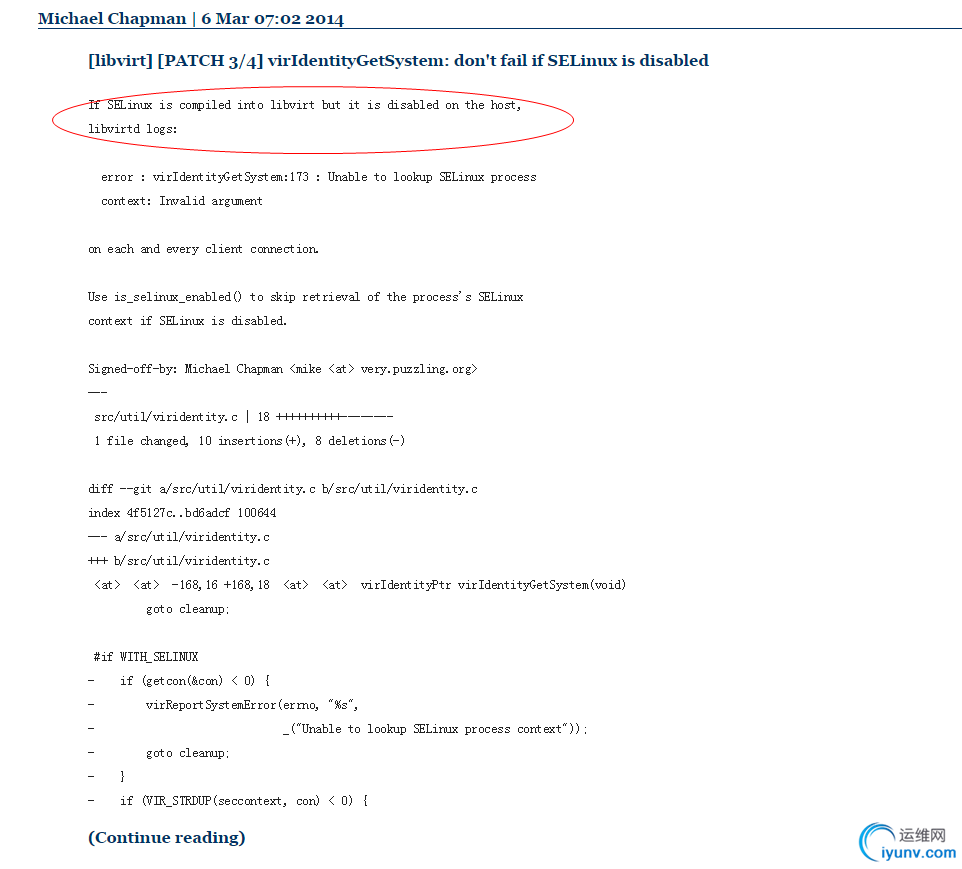

问题木有解决,继续,重新编译libvirt:
./configure --prefix=/usr/local/libvirt/ --with-selinux=no
selinux问题解决了。again:
这次成功了,什么都不改变,后面不能成功了???

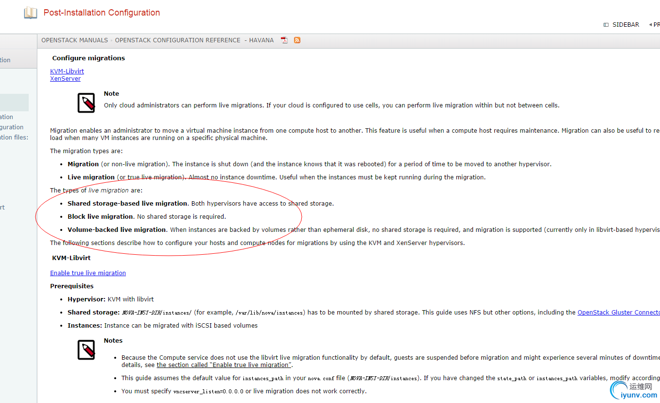

上图中的volume-backed是指的xml等文件也共享呢?但是nfs也是共享了的。。。疑惑ing~~~~
如果是nfs那么/var/lib/nova/instance文件夹是共享的,里面的xml文件也共享,
那么如果是nfs的迁移则不需要迁移xml文件(因为各个节点共享)。
但如果是ceph-backed,则需要将libvirt的xml等文件迁移复制过去。

63compute日志:
找到文件:

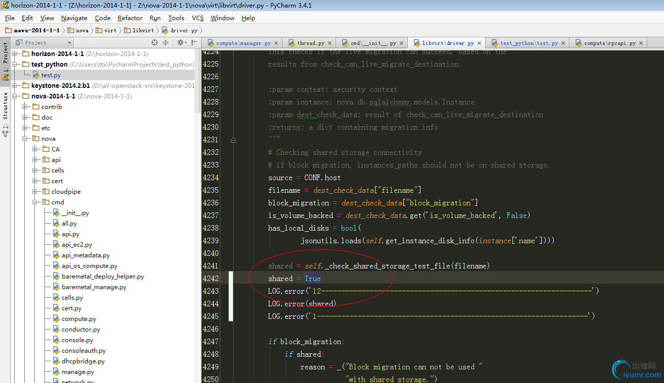

/usr/lib/python2.6/site-packages/nova/virt/libvirt/driver.py", line 4255, in check_can_live_migrate_source

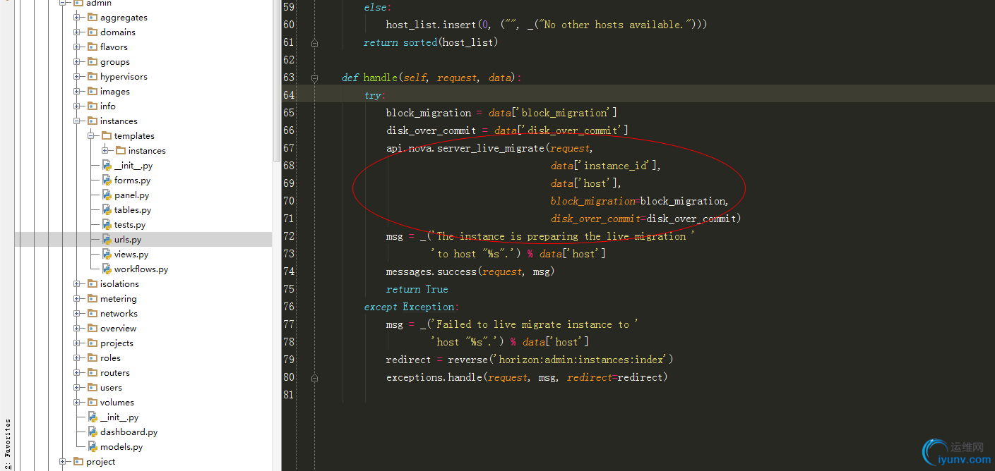

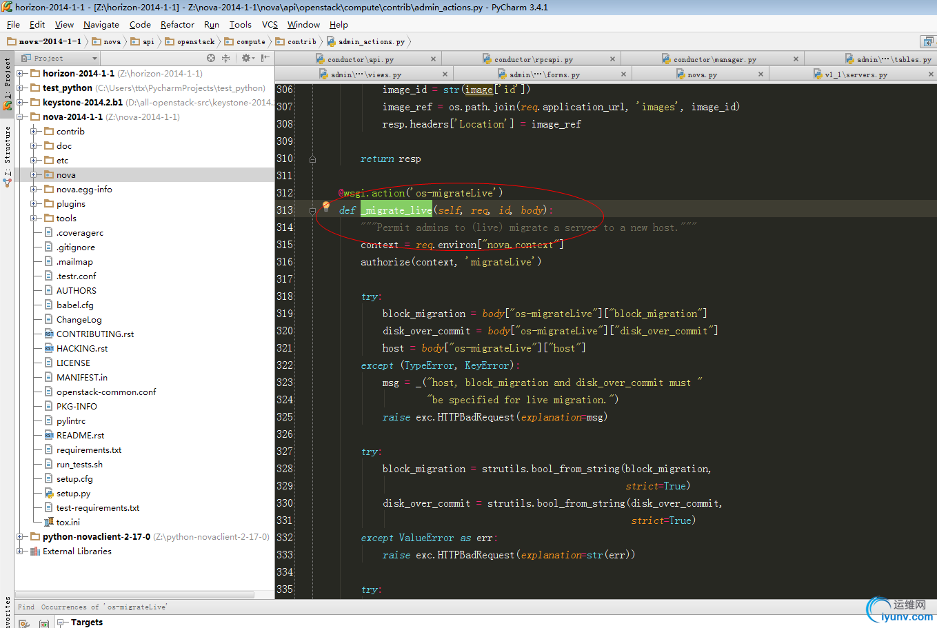

https://blueprints.launchpad.net/nova/+spec/live-migration-to-conductor
由上述可知:live_migrate的执行流程为:dashboard->novaclient->nova-api->nova-conductor->nova-compute->virt.libvirt.driver.py.
从上图打印的值,可以看出is_volume_backed:False,似乎有bug,继续跟踪下去。
查看fule对应处的输出:
上述两处的差别在于,fuel代码中传递了image_type==rbd参数。(其实,在nova.conf配置文件中会配置,images_type=rbd项,因此不需要传递参数,自己根据配置文件修改即可。)
原始代码:
修改后代码:
再次实验:
迁移成功。

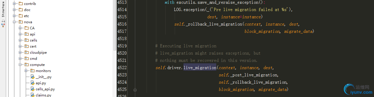

所以还得继续跟踪源码:
根进到driver.live_migration()

日志说明是在 dom.migrateToURI函数执行后异常错误(即调用libvirt出异常)。
打印fuel代码:
日志打印一致,则说明在之前步骤中,原生nova没有pre-create文件夹。
用fule代码:
说明在 dom.migrateToURI()之前自动创建了文件夹。
再来看原生代码:
说明原生代码没有pre-create实例相应的文件夹。

2、  配置libvirt1.1.2
修改文件
修改文件
9
listen_tls = 0
listen_tcp = 1
tcp_port = "16509"
auth_tcp = "none"
运行 libvirtd
