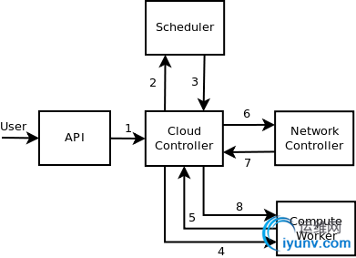

综述
启动一个新的instance涉及到很多openstack nova里面的组件
  • API server:处理客户端的请求,并且转发到cloud control
  • Cloud control:处理compute节点,网络控制节点,API server和scheduler中间连接
  • Scheduler:选择一个host去执行命令
  • compute worker:启动和停止实例,附加和删除卷 等操作
  • network controller:管理网络资源,分配固定IP,配置vlans
  1.API server将消息发送到Cloud Controller
  2. Authertication 保用户有权限,然后Cloud Controller将消息发送给Scheduler
  3. Scheduler caste 一个消息给一个选择好的host要求他启动一个实例
  4.compute worker(选择的那个host)获取到消息
  5.6.7.8 compute worker需要一个固定的ip去启动一个实例,所以向network controller发送消息

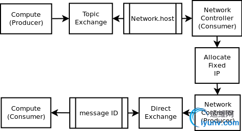

network controller
network_info = self._allocate_network(context, instance,
                                                  requested_networks)
调用network的API的allocate_for_instance方法
[python]
view plaincopyprint?
  • def allocate_for_instance(self, context, instance, **kwargs):
  •         """Allocates all network structures for an instance.
  •         :returns: network info as from get_instance_nw_info() below
  •         args = kwargs
  •         args['instance_id'] = instance['id']
  •         args['instance_uuid'] = instance['uuid']
  •         args['project_id'] = instance['project_id']
  •         args['host'] = instance['host']
  •         args['rxtx_factor'] = instance['instance_type']['rxtx_factor']
  •         nw_info = rpc.call(context, FLAGS.network_topic,
  •                            {'method':
    'allocate_for_instance',
  •                              'args': args})
args = kwargs
{'method': 'allocate_for_instance',
'args': args})RPC.call 与RPC.cast最大的不同 就是call方法需要一个response
