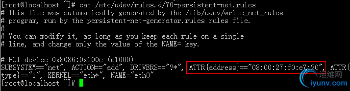

1. vi  /etc/udev/rules.d/70-persistent-net.rules
-----把“SUBSYSTEM=="net",ACTION=="add",DRIVERS=="?*",ATTR{address}=="00:0c:29:50:bd:17", ATTR{type}=="1", KERNEL=="eth*", NAME="eth1"
中的“eth1”改为“eth0
----- reboot  重启系统

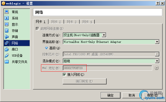

打开/etc/sysconfig/network-scripts/ifcfg-eth0
# vi /etc/sysconfig/network-scripts/ifcfg-eth0
HWADDR="00:0c:29:8f:89:97" 改成上面的mac地址 HWADDR="00:0c:29:50:bd:17"
最后,重启网络
# service network restart
VirtualBox中虚拟机被克隆后需要的注意事项
  确保一下三个方面的MAC地址相同,网络才不会出问题。
  [iyunv@localhost ~]# cat /etc/udev/rules.d/70-persistent-net.rules
  [iyunv@localhost ~]# cat /etc/sysconfig/network-scripts/ifcfg-eth0
