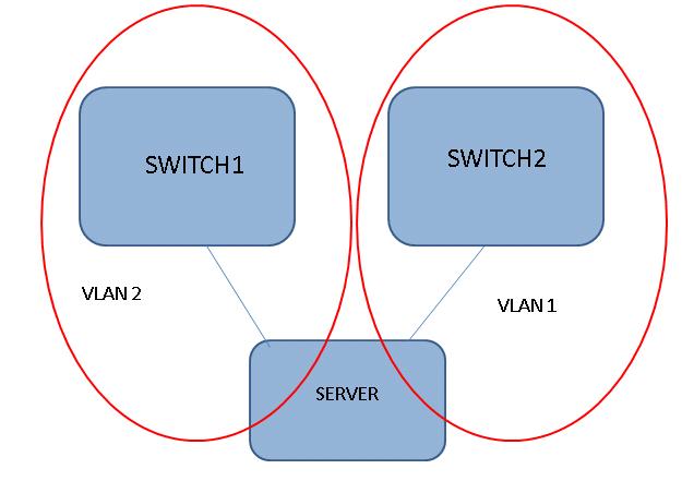

第四种:bond3:fault-tolerance (broadcast)
标准文档定义:Broadcast policy: transmits everything on all slave interfaces. This mode provides fault tolerance.
特点:这种模式的特点是一个报文会复制两份往bond下的两个接口分别发送出去,当有对端交换机失效,我们感觉不到任何downtime,但此法过于浪费资源;不过这种模式有很好的容错机制。此模式适用于金融行业,因为他们需要高可靠性的网络,不允许出现任何问题。
实际绑定结果:
root@ubuntu12:~/ram# cat /proc/net/bonding/bond0
Ethernet Channel Bonding Driver: v3.6.0 (September 26, 2009)
Bonding Mode: fault-tolerance (broadcast)   ------- fault-tolerance 模式
MII Status: up
MII Polling Interval (ms): 100
Up Delay (ms): 0
Down Delay (ms): 0
Slave Interface: eth0
MII Status: up
Link Failure Count: 0
Permanent HW addr: 74:ea:3a:6a:54:e3
Slave Interface: eth1
MII Status: up
Permanent HW addr: d8:5d:4c:71:f9:94
应用拓扑:如下:
这种模式适用于如下拓扑,两个接口分别接入两台交换机,并且属于不同的vlan,当一边的网络出现故障不会影响服务器另一边接入的网络正常工作。而且故障过程是0丢包。下面展示了这种模式下ping信息:
64 bytes from 1.1.1.1: icmp_seq=901 ttl=64 time=0.205 ms
64 bytes from 1.1.1.1: icmp_seq=901 ttl=64 time=0.213 ms (DUP!)  ---dup为重复报文
64 bytes from 1.1.1.1: icmp_seq=902 ttl=64 time=0.245 ms
64 bytes from 1.1.1.1: icmp_seq=902 ttl=64 time=0.254 ms (DUP!)
64 bytes from 1.1.1.1: icmp_seq=903 ttl=64 time=0.216 ms
64 bytes from 1.1.1.1: icmp_seq=903 ttl=64 time=0.226 ms (DUP!)
从这个ping信息可以看到,这种模式的特点是,同一个报文服务器会复制两份分别往两条线路发送,导致回复两份重复报文,这种模式有浪费资源的嫌疑。

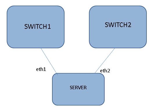

第六种:bond5: transmit load balancing
标准文档定义:Adaptive transmit load balancing: channel bonding that does  not require any special switch support. The outgoing traffic is  distributed according to the current load (computed relative to the  speed) on each slave. Incoming traffic is received by the current slave.  If the receiving slave fails, another slave takes over the MAC address  of the failed receiving slave. Prerequisite: Ethtool support in the base  drivers for retrieving the speed of each slave.
特点:balance-tlb模式通过对端均衡外出(outgoing)流量。既然它是根据MAC地址进行均衡,在“网关”型配置(如上文所述) 下,该模式会通过单个设备来发送所有流量,然而,在“本地”型网络配置下,该模式以相对智能的方式(不是balance-xor或802.3ad模式里提 及的XOR方式)来均衡多个本地网络对端,因此那些数字不幸的MAC地址(比如XOR得到同样值)不会聚集到同一个接口上。
不像802.3ad,该模式的接口可以有不同的速率,而且不需要特别的交换机配置。不利的一面在于,该模式下所有进入的(incoming)流量会到达同一个接口;该模式要求slave接口的网络设备驱动有某种ethtool支持;而且ARP监控不可用。
实际配置结果:
Ethernet Channel Bonding Driver: v3.0.3 (March 23, 2006)
Bonding Mode: transmit load balancing   -----TLB模式
Primary Slave: None
Currently Active Slave: eth1
MII Status: up
Up Delay (ms): 0
Down Delay (ms): 0
MII Status: up
Permanent HW addr: 00:d0:f8:40:f1:a0
Slave Interface: eth2
MII Status: up
Permanent HW addr: 00:d0:f8:00:0c:0c
应用拓扑:这个模式下bond成员使用各自的mac,而不是上面几种模式是使用bond0接口的mac。
如上图,设备开始时会发送免费arp,以主端口eth1的mac为源,当客户端收到这个arp时就会在arp缓存中记录下这个mac对的ip。而在这个模 式下,服务器每个端口在ping操作时,会根据算法算出出口,地址不断变化时他,这时会负载到不同端口。实验中ping1.1.1.3时往eth2发送, 源mac为00:D0:F8:00:0C:0C,ping1.1.1.4是往eth1发送,源mac为00:D0:F8:40:F1:A0,以此类推,所 以从服务器出去的流量负载到两条线路,但是由于服务发arp时只用00:D0:F8:40:F1:A0,这样客户端缓冲记录的是 00:D0:F8:40:F1:A0对的ip,封装时目标mac:00:D0:F8:40:F1:A0。这样进入服务的流量都只往 eth1(00:D0:F8:40:F1:A0)走。设备会一直发入snap报文,eth1发送源为00d0.f840.f1a0的snap报 文,eth2发送源为00d0.f800.0c0c的snap报文。这个snap报文mac和目标mac一样都是网卡本地mac,源ip和目标ip也一 样,这个报文的作用是检测线路是否正常的回环报文。
注:可以通过修改bond0的mac地址来引导他发修改后的源mac的免费arp(MACADDR=00:D0:F8:00:0C:0C)

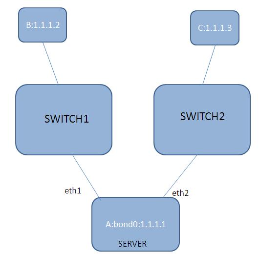

第七种:bond6:adaptive load balancing
特点:该模式包含了balance-tlb模式,同时加上针对IPV4流量的接收负载均衡(receive load balance,  rlb),而且不需要任何switch(交换机)的支持。接收负载均衡是通过ARP协商实现的。bonding驱动截获本机发送的ARP应答,并把源硬件 地址改写为bond中某个slave的唯一硬件地址,从而使得不同的对端使用不同的硬件地址进行通信。所有端口都会收到对端的arp请求报文,回复arp 回时,bond驱动模块会截获所发的arp回复报文,根据算法算到相应端口,这时会把arp回复报文的源mac,send源mac都改成相应端口mac。 从抓包情况分析回复报文是第一个从端口1发,第二个从端口2发。以此类推。
(还有一个点:每个端口除发送本端口回复的报文,也同样会发送其他端口回复的报文,mac还是其他端口的mac)这样来自服务器端的接收流量也会被均衡。
当本机发送ARP请求时,bonding驱动把对端的IP信息从ARP包中复制并保存下来。当ARP应答从对端到达时,bonding驱动把它的硬件地址 提取出来,并发起一个ARP应答给bond中的某个slave(这个算法和上面一样,比如算到1口,就给发送arp请求,1回复时mac用1的mac)。 使用ARP协商进行负载均衡的一个问题是:每次广播  ARP请求时都会使用bond的硬件地址,因此对端学习到这个硬件地址后,接收流量将会全部流向当前的slave。这个问题通过给所有的对端发送更新 (ARP应答)来解决,往所有端口发送应答,应答中包含他们独一无二的硬件地址,从而导致流量重新分布。当新的slave加入到bond中时,或者某个未 激活的slave重新激活时,接收流量也要重新分布。接收的负载被顺序地分布(round robin)在bond中最高速的slave上
当某个链路被重新接上,或者一个新的slave加入到bond中,接收流量在所有当前激活的slave中全部重新分配,通过使用指定的MAC地址给每个  client发起ARP应答。下面介绍的updelay参数必须被设置为某个大于等于switch(交换机)转发延时的值,从而保证发往对端的ARP应答 不会被switch(交换机)阻截。
必要条件:
条件1:ethtool支持获取每个slave的速率;
条件2:底层驱动支持设置某个设备的硬件地址,从而使得总是有个slave(curr_active_slave)使用bond的硬件地址,同时保证每个 bond 中的slave都有一个唯一的硬件地址。如果curr_active_slave出故障,它的硬件地址将会被新选出来的  curr_active_slave接管。
实际配置结果:
root@:/tmp#  cat /proc/net/bonding/bond0
Bonding Mode: adaptive load balancing
Primary Slave: None
Currently Active Slave: eth0
MII Status: up
Up Delay (ms): 0
Down Delay (ms): 0
MII Status: up
MII Status: up
应用拓扑:
A是双网卡绑定。
当B  发送一个arp请求到达A时,按正常情况A会回应一个arp回应报文,源mac为bond的mac,源就是bond的ip。但是这个模式下bonding 驱动会截获这个arp回应,把源mac改成bond状态  下其中某一个网卡的mac:mac1,这样B收到这个arp回应时就会在arp缓存中记录下ip:1.1.1.1对应的mac为mac1。这样B的过来的 流量都走MAC1.
当C  发送一个arp请求到达A时,按正常情况A会回应一个arp回应报文,源mac为bond的mac,源就是bond的ip。但是这个模式下bonding 驱动会截获这个arp回应,把源mac改成bond状态  下其中某一个网卡的mac:mac2,这样C收到这个arp回应时就会在arp缓存中记录下ip:1.1.1.1对应的mac为mac2。这样C的过来的 流量都走MAC2.
这样就可以做到回来让回来的流量也负载均衡。出方向均衡和MODE=5一致,不同地址会根据xor算法算出不同出口,发不同出口发送相应的arp ,mac是对应网卡的mac。
