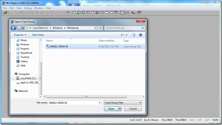

解决方案:首先使用Windows Driver Kit 7.1中的Windows Debugging Tool (WinDBG)分析内存转储文件

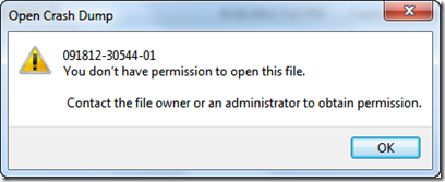

如果提示:
则用Administrator身份运行WinDbg。

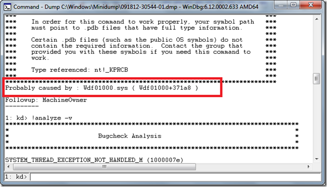

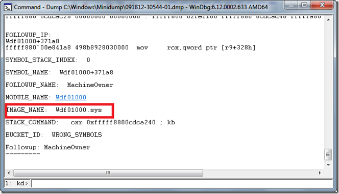

在查看了相关信息后(如下图的图c),可以点击或者在Console中输入 "!analyze-v”查看详细的分析结果,下图图d。

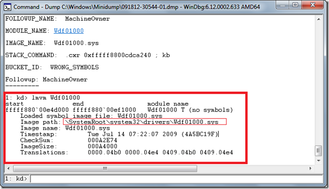

查阅wdf的相关信息,先查看一下wdf01000.sys是不是系统文件。
找到文件位置,查看它的属性,发现是Windows的系统文件,而且还是内核模式驱动框架运行时程序(原文是Kernel Mode Driver Framework Runtime ),这个以前从没接触过,怀疑是系统bug,正如前面WinDbg说的,“
This is a very common bugcheck.  Usually the exception address pinpoints
the driver/function that caused the problem.  Always note this address
as well as the link date of the driver/image that contains this address.
Some common problems are exception code 0x80000003.  This means a hard
coded breakpoint or assertion was hit, but this system was booted
/NODEBUG.  This is not supposed to happen as developers should never have
hardcoded breakpoints in retail code, but ...
If this happens, make sure a debugger gets connected, and the
system is booted /DEBUG.  This will let us see why this breakpoint is
happening.
这个问题目前只能提交给微软的工程师来解决了。

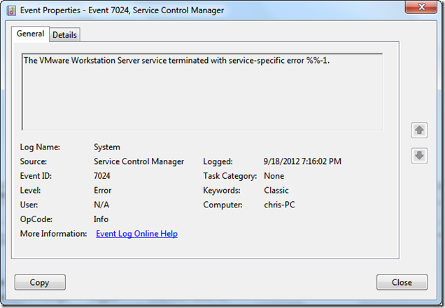

打开服务管理控制台,尝试手动启动VMwareHostd(服务名,显示名称为VMware Workstation Server)服务,结果遇到错误提示,如下图所示。
图a是获取服务名,对以后的使用会有帮助。
图b是错误提示。
0(图b)
但是VMware里的虚拟机还是可以使用的。
解决方案:通过Windows事件查看器的在线帮助查找是否有解决方案。
网址为http://technet.microsoft.com/en-us/library/ab3f45e5-f0ec-49d0-b4f7-d4581984f420.aspx
此页面提示访问Vendor(制造商、开发商)官方网站寻求办法。
根据下图的提示搜索。
找到几个有用的:
<The VMware Workstation Server service terminated with service-specific error %%-1.>
