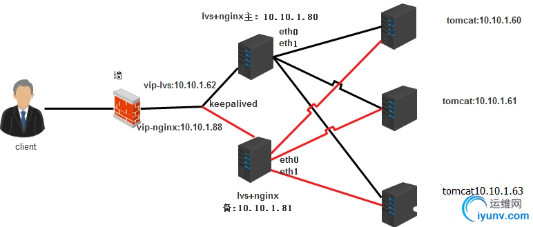

第一步:安装LVS和Nginx,keepalived
                   Yum–y install ipvsadm keepalived
                   编译安装nginx
                   ./configure–prefix=    ,make&&makeinstall
第二步:设置ipvsadm规则
                   Ipvsadm–A –t 10.10.1.62:3380 –s rr
                   Ipvsadm–a –t 10.10.1.62:3380 –r 10.10.1.60 –g –w1
                   Ipvsadm–a –t 10.10.1.62:3380 –r 10.10.1.61 –g –w1
                   Ipvsadm–a –t 10.10.1.62:3380 –r 10.10.1.63 –g –w1
                   Ipvsadm–A –t 10.10.1.88:80 –s rr
                   Ipvsadm–a –t 10.10.1.88:80 –r 10.10.1.80 –g –w1
                   Ipvsadm–a –t 10.10.1.88:80 –r 10.10.1.81 –g –w1
                   保存规则:ipvsadm –S< /jiaoben/ipvsadm.txt

第四步:keepalived的配置文件的修改
! Configuration File for keepalived
global_defs {
  notification_email {
    root@localhost
  notification_email_from Alexandre.Cassen@firewall.loc
  smtp_server 127.0.0.1
  smtp_connect_timeout 30
  router_id LVS_DEVEL
vrrp_instance VI_1 {
   state BACKUP         #从机
   interface eth0
   virtual_router_id 51
   priority 150         #定义优先级,数字大优先极高
   advert_int 1
    nopreempt            #不抢占
   authentication {
       auth_type PASS   #简单的连接样式
       auth_pass 1111   #简单的密码
   virtual_ipaddress {
       10.10.1.62/32 dev eth0
       10.10.1.88/32 dev eth1

#=================nginx的HA========啊万恶的分割线啊!!==================================

注意:keepalived.conf的配置
    stateBACKUP  的状态均为从,
    priority100         #定义优先级,数字大优先极高,决定主从。
唯一的不足时当nginx的宕掉是,keepalived是不会漂移的,需要增加检测脚本,当nginx挂掉时,强制keepalived stop。
