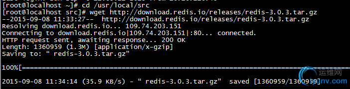

cd /usr/local/src
wget http://download.redis.io/releases/redis-3.0.3.tar.gz
tar -zxf redis-3.0.3.tar.gz

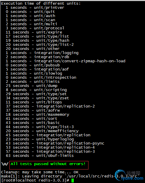

make test

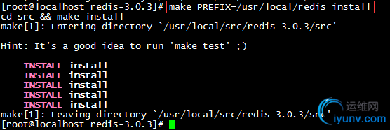

make PREFIX=/usr/local/redis install

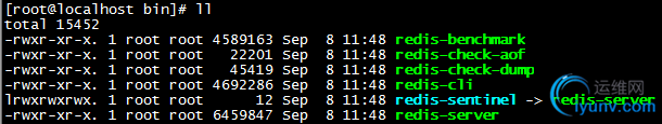

  其中PREFIX=/usr/local/redis可以省略,省略情况下redis会默认安装到/usr/local/bin目录下。测试通过后安装,安装后会自动把redis-server,redis-cli,redis-benchmark,redis-check-aof,redis-check-dump复制到/usr/local/redis/bin目录下。
