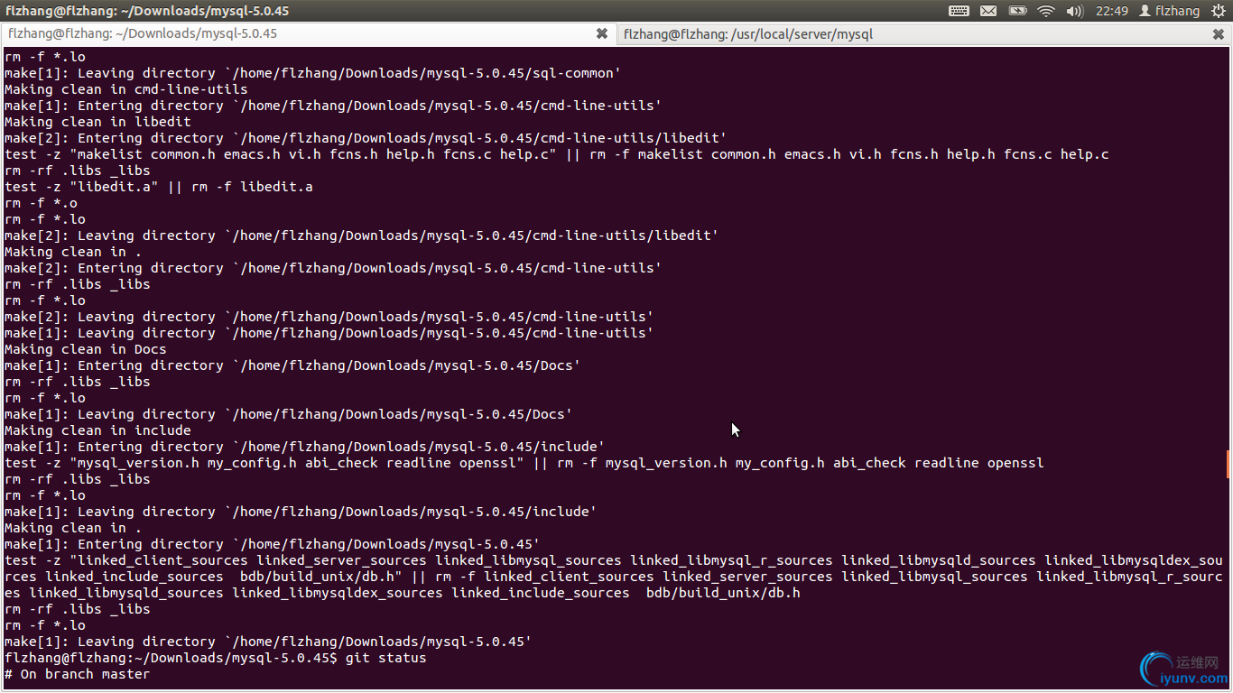

  接下来就是编译MySQL,在mysql-5.0.45目录下键入“sudo make && make install clean”:
  flzhang@flzhang:~/Downloads/mysql-5.0.45$ make && make install clean
  成功后如图示:

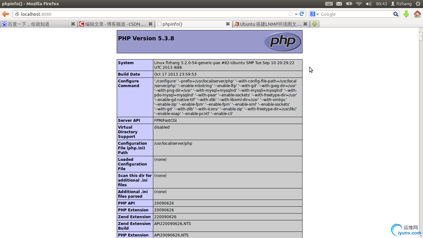

安装PHP:
  下载:wget http://cn2.php.net/distributions/php-5.3.8.tar.gz
  解压:tar zxvf php-5.3.8.tar.gz
  配置: ./configure --prefix=/usr/local/server/php --with-config-file-path=/usr/local/server/php --enable-mbstring --enable-ftp --with-gd --with-jpeg-dir=/usr --with-png-dir=/usr --with-mysql=mysqlnd --with-mysqli=mysqlnd --with-pdo-mysql=mysqlnd --with-pear --enable-sockets --with-freetype-dir=/usr --enable-gd-native-ttf --with-zlib --with-libxml-dir=/usr --with-xmlrpc --enable-zip --enable-fpm --enable-fpm --enable-xml --enable-sockets --with-gd --with-zlib --with-iconv --enable-zip --with-freetype-dir=/usr/lib/ --enable-soap --enable-pcntl --enable-cli
  途中出现如下错误:
checking libxml2 install dir... /usr
checking for xml2-config path...
configure: error: xml2-config not found. Please check your libxml2 installation.
flzhang@flzhang:~/Downloads/php-5.3.8$
解决方法:flzhang@flzhang:~/Downloads/php-5.3.8$ sudo apt-get install libxml2-dev
  重新执行:./configure --prefix=/usr/local/server/php --with-config-file-path=/usr/local/server/php --enable-mbstring --enable-ftp --with-gd --with-jpeg-dir=/usr --with-png-dir=/usr --with-mysql=mysqlnd --with-mysqli=mysqlnd --with-pdo-mysql=mysqlnd --with-pear --enable-sockets --with-freetype-dir=/usr --enable-gd-native-ttf --with-zlib --with-libxml-dir=/usr --with-xmlrpc --enable-zip --enable-fpm --enable-fpm --enable-xml --enable-sockets --with-gd --with-zlib --with-iconv --enable-zip --with-freetype-dir=/usr/lib/ --enable-soap --enable-pcntl --enable-cli
  成功如下所示:

  重启nginx,执行“sudo /etc/init.d/nginx reload”回车,并开启PHP。打开浏览器,输入“http://127.0.0.1:8080”,如下图所示:
  好了,至此,关于LNMP的搭建已算完成了..................................
