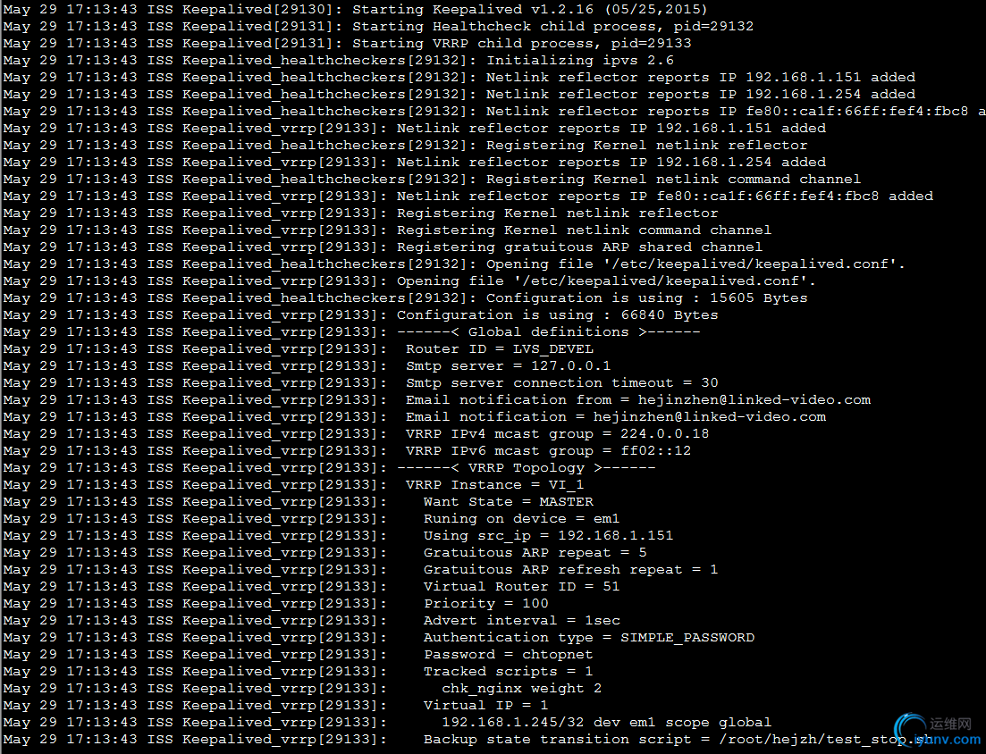

  启动keepalived:
service keepalived start
启动日志:
