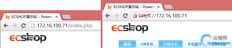

web4上停止httpd服务:
12[iyunv@web4~]#service httpd stopStoppinghttpd:           https已不能访问(backend https-servers只定义了web4),但http仍能正常访问 DSC0001.png

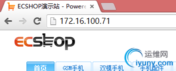

123[iyunv@ha1~]#scp /etc/haproxy/{haproxy.cfg,server.pem} 172.16.100.72:/etc/haproxy/[iyunv@ha2~]#service haproxy startStartinghaproxy:                                          [  OK  ]测试

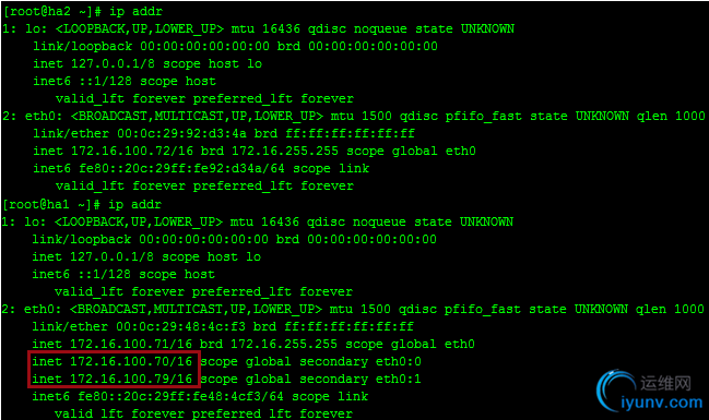

123456789101112131415161718[iyunv@ha1keepalived]#diff keepalived.conf keepalived.conf.ha225,26c25,26<    state MASTER  #BACKUP for slave routers<    priority 101  #100 for BACKUP--->    state BACKUP  #BACKUP for slave routers>    priority 100  #100 for BACKUP48,49c48,49<    state BACKUP  #BACKUP for slave routers<    priority 100  #100 for BACKUP--->    state MASTER  #BACKUP for slave routers>    priority 101  #100 for BACKUP[iyunv@ha1~]#scp /etc/keepalived/keepalived.conf.ha2 172.16.100.72:/etc/keepalived/keepalived.conf[iyunv@ha1~]#service keepalived startStartingkeepalived:                                       [  OK  ][iyunv@ha2~]#service keepalived startStartingkeepalived:                                       [  OK  ] DSC0004.png

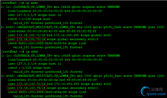

故障转移:
12[iyunv@ha2~]#service haproxy stopShuttingdown haproxy:                                     [  OK  ]vip漂到了ha1上
