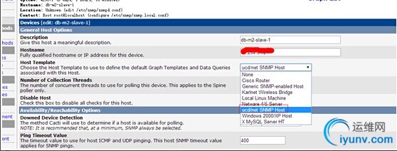

(一):添加io监控
  点击Create Graphs for this Host 进去创建IO的图,结果报错
  This data query returned 0 rows, perhaps there was a problem executing this data query. You can run this data query in debug mode to get more information.

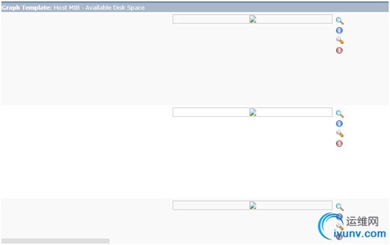

  (二):MySQL添加主机出不来图

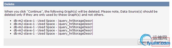

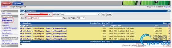

  报错(六):
  移除出错的图
  进去Consoleà Graph Management àHost(选择出错的主机地址)—>Search(搜索报错的关键字Used Space),就会找到报错不出错的Graph Title栏目,勾选右侧的全选框,点击Go按钮删除掉这些无效的图即可,如下图所示:
  然后在新出来的提示界面,点击Continue按钮,删除。

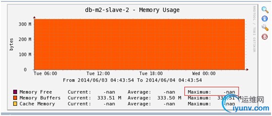

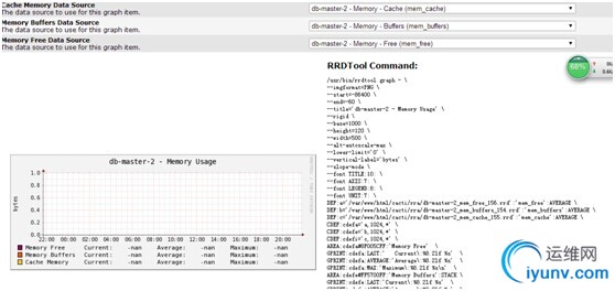

  (七):Memory Free值为nan
  分析:memery free 无数据,原因: rrdtool  的内存上限为10G
  [iyunv@squid-2 local]# find / -name *mem*.rrd
  /var/www/html/cacti/rra/db-m2-slave-1_mem_buffers_189.rrd
  /var/www/html/cacti/rra/db-master-2_mem_free_156.rrd
  /var/www/html/cacti/rra/db-m2-slave-1_lock_system_memory_20.rrd
  /var/www/html/cacti/rra/db-m2-slave-2_total_mem_alloc_74.rrd
  /var/www/html/cacti/rra/db-m2-slave-1_total_mem_alloc_23.rrd
  /var/www/html/cacti/rra/db-m2-slave-2_lock_system_memory_71.rrd
  /var/www/html/cacti/rra/localhost_mem_swap_4.rrd
  /var/www/html/cacti/rra/db-master-2_total_mem_alloc_117.rrd
  /var/www/html/cacti/rra/db-master-2_mem_cache_155.rrd
  /var/www/html/cacti/rra/db-master-2_mem_buffers_154.rrd
  /var/www/html/cacti/rra/db-m2-slave-1_mem_free_191.rrd
  /var/www/html/cacti/rra/localhost_mem_buffers_3.rrd
  /var/www/html/cacti/rra/db-m2-slave-2_mem_free_164.rrd
  /var/www/html/cacti/rra/db-m2-slave-2_mem_buffers_162.rrd
  /var/www/html/cacti/rra/db-m2-slave-1_mem_buffers_54.rrd
  /var/www/html/cacti/rra/db-m2-slave-1_mem_swap_55.rrd
  /var/www/html/cacti/rra/db-master-2_lock_system_memory_114.rrd
  /var/www/html/cacti/rra/db-m2-slave-2_mem_cache_163.rrd
  /var/www/html/cacti/rra/db-m2-slave-1_mem_cache_190.rrd
  /var/www/html/cacti/rra/db-master-2_mem_free_146.rrd
  [iyunv@squid-2 local]# rrdtool info /var/www/html/cacti/rra/db-m2-slave-1_mem_free_191.rrd |grep mem_free
  filename = &quot;/var/www/html/cacti/rra/db-m2-slave-1_mem_free_191.rrd&quot;
  ds[mem_free].type = &quot;GAUGE&quot;
  ds[mem_free].minimal_heartbeat = 120
  ds[mem_free].min = 0.0000000000e+00
  ds[mem_free].max = 1.0000000000e+07
  ds[mem_free].last_ds = &quot;34166500&quot;
  ds[mem_free].value = NaN
  ds[mem_free].unknown_sec = 2
  注:ds[mem_free].max = 1.0000000000e+07  数据的最大值设置为10G

【补充】

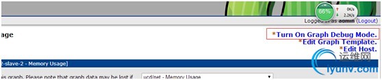

  调试cacti的graph,步骤如下:
  (1)     Console ,再进入Graph Manager ,再进入,选择对于的Host,搜索Memory,选中你要的图,点击链接,比如我这里是Memory Usage,如下图所示:
  (2)     再 点击Memory Usage链接进去,点击右上角的Debug模式:
  (3)     就会看到如下的debug界面,可以慢慢来观察RRDTool Command命令,为何是-nan值。

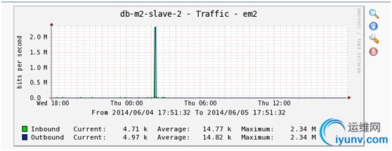

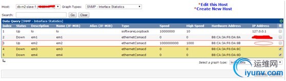

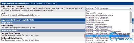

  (八):双网卡 Traffic 网卡流量问题
  如下图,em1和em2全部指向一个ip地址,只是em1不生效,em2生效了,但是ip地址在em1上,没有显示在em2一栏。
  所以,在graph图上,就没有数据,全为-nan-值,如下所示:
  cacti服务器上面执行check
  [iyunv@squid-2 rra]# snmpwalk -v 2c -c public 10.254.3.72 IF-MIB::ifDescr
  IF-MIB::ifDescr.1 = STRING: lo
  IF-MIB::ifDescr.2 = STRING: em1
  IF-MIB::ifDescr.3 = STRING: em2
  IF-MIB::ifDescr.4 = STRING: em3
  IF-MIB::ifDescr.5 = STRING: em4
  确实有4个网卡信息记录,这些都没事,正常,经过仔细排查发现主要原因在下拉选框里面要选择Interface – Traffic (bits/sec),不要选择Interface – Traffic (bytes/sec),如下图所示:
  当选择了Interface – Traffic (bits/sec)之后graph就会出数据,有效果图了。
