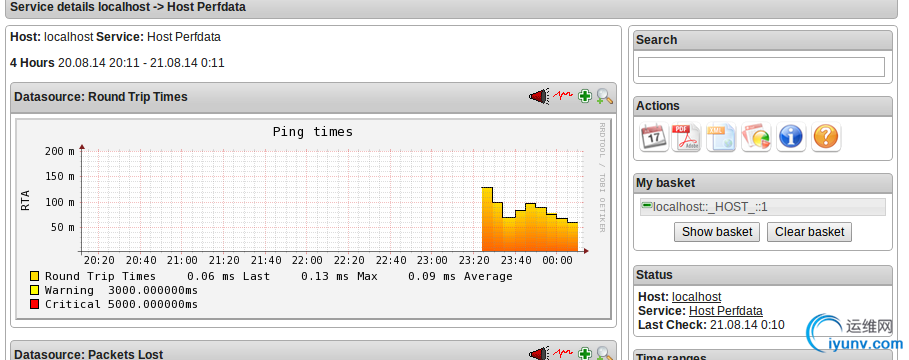

于是就尝试了一下Bulk mode,因为这个模式下可以自己指定数据的位置以及数据格式,按照官网的配置方式配置一下。OK搞定,pnp4nagios的日志内容为
2014-08-20 23:23:55 [2237] [2] Using Config File /usr/local/pnp4nagios/etc/process_perfdata.cfg parameters
2014-08-20 23:23:55 [2237] [2] Default Timeout: 15 secs.
2014-08-20 23:23:55 [2237] [2] Config Timeout: 15 secs.
2014-08-20 23:23:55 [2237] [2] Actual Timeout: 15 secs.
2014-08-20 23:23:55 [2237] [1] process_perfdata.pl-0.6.24 starting in BULK Mode called by Nagios
2014-08-20 23:23:55 [2237] [2] searching for /usr/local/pnp4nagios/var/service-perfdata
2014-08-20 23:23:55 [2237] [2] renaming /usr/local/pnp4nagios/var/service-perfdata to /usr/local/pnp4nagios/var/service-perfdata-PID-2237 for bulk update
2014-08-20 23:23:55 [2237] [2] reading /usr/local/pnp4nagios/var/service-perfdata-PID-2237 for bulk update
2014-08-20 23:23:55 [2237] [2] Processing Line 1
2014-08-20 23:23:55 [2237] [2] Datatype set to 'SERVICEPERFDATA'
2014-08-20 23:23:55 [2237] [1] Found Performance Data for localhost / Swap_Usage (swap=1635MB;0;0;0;1635)
2014-08-20 23:23:55 [2237] [2] data2rrd called
2014-08-20 23:23:55 [2237] [2] Reading /usr/local/pnp4nagios/etc/rra.cfg
2014-08-20 23:23:55 [2237] [2] RRDs::create /usr/local/pnp4nagios/var/perfdata/localhost/Swap_Usage.rrd RRA:AVERAGE:0.5:1:2880 RRA:AVERAGE:0.5:5:2880 RRA:AVERAGE:0.5:30:4320 RRA:AVERAGE:0.5:360:5840 RRA:MAX:0.5:1:2880 RRA:MAX:0.5:5:2880 RRA:MAX:0.5:30:4320 RRA:MAX:0.5:360:5840 RRA:MIN:0.5:1:2880 RRA:MIN:0.5:5:2880 RRA:MIN:0.5:30:4320 RRA:MIN:0.5:360:5840 DS:1:GAUGE:8460:U:U --start=1408591427 --step=60
2014-08-20 23:23:55 [2237] [2] /usr/local/pnp4nagios/var/perfdata/localhost/Swap_Usage.rrd created
2014-08-20 23:23:55 [2237] [1] 1 lines processed
2014-08-20 23:23:55 [2237] [1] /usr/local/pnp4nagios/var/service-perfdata-PID-2237 deleted
2014-08-20 23:23:55 [2237] [1] PNP exiting (runtime 0.156996s) ...
2014-08-20 23:24:24 [2301] [2] Using Config File /usr/local/pnp4nagios/etc/process_perfdata.cfg parameters
2014-08-20 23:24:24 [2301] [2] Default Timeout: 15 secs.
2014-08-20 23:24:24 [2301] [2] Config Timeout: 15 secs.
2014-08-20 23:24:24 [2301] [2] Actual Timeout: 15 secs.
2014-08-20 23:24:24 [2301] [1] process_perfdata.pl-0.6.24 starting in BULK Mode called by Nagios
2014-08-20 23:24:24 [2301] [2] searching for /usr/local/pnp4nagios/var/service-perfdata
2014-08-20 23:24:24 [2301] [2] renaming /usr/local/pnp4nagios/var/service-perfdata to /usr/local/pnp4nagios/var
正常处理了一行数据。
界面如下
