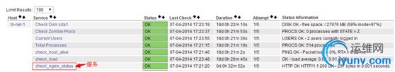

(6)     重新加载nagios
[iyunv@cache-2 objects]# service nagios reload
Running configuration check...
Reloading nagios configuration...
done
(7)     查看界面的nginx监控服务,如下所示:
