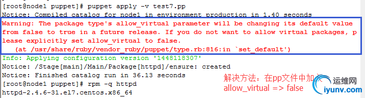

例子: test7.pp
package {"httpd":
   ensure  => present,
   allow_virtual => false,
[iyunv@node1 puppet]# rpm -q httpd
package httpd is not installed
