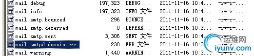

  更加细化的分选
# Logging for the mail system.  Split it up so that
# it is easy to write scripts to parse these files.
#only log smtpd domain error
$template mailOkFail,&quot;%timegenerated% %msg%\n&quot;
if ($syslogtag startswith 'postfix/smtpd[') and ($msg contains 'Domain not found') then /var/log/mail.smtpd.domain.err;mailOkFail
#send ok
if ($syslogtag startswith 'postfix/smtp[') and ($msg contains 'status=sent') then /var/log/mail.smtp.sent;mailOkFail
#bound status=bounced
if ($syslogtag startswith 'postfix/smtp[') and ($msg contains 'status=bounced') then /var/log/mail.smtp.bounced;mailOkFail
#deferred
if ($syslogtag startswith 'postfix/smtp[') and ($msg contains 'status=deferred') then /var/log/mail.smtp.deferred;mailOkFail
  但是查看 了一下,发现日志中没有信的标题(某种程序上,如不存在相同标题的信)或是发件人(发件人与信相关,且唯一,因为向外发,用户并不重要),需要更改postfix程序在每个日志中都有mail from 和rcpt to这样就可以从日志中根据mail from区别不同信,而进行一封信的统计
