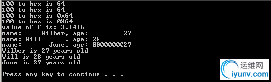

  看一些简单的 例子:
num = 100
print "%d to hex is %x" %(num, num)
print "%d to hex is %X" %(num, num)
print "%d to hex is %#x" %(num, num)
print "%d to hex is %#X" %(num, num)
# 浮点数
f = 3.1415926
print "value of f is: %.4f" %f
# 指定宽度和对齐
students = [{"name":"Wilber", "age":27}, {"name":"Will", "age":28}, {"name":"June", "age":27}]
print "name: %10s, age: %10d" %(students[0]["name"], students[0]["age"])
print "name: %-10s, age: %-10d" %(students[1]["name"], students[1]["age"])
print "name: %*s, age: %0*d" %(10, students[2]["name"], 10, students[2]["age"])
# dict参数
for student in students:
print "%(name)s is %(age)d years old" %student
  代码输出为:
  对于Python的格式化操作符,不仅可以接受tuple类型的参数,也可以支持dict,象上面代码的最后一部分,那么格式化字符串中就可以直接使用"%(key)s"(这里的s根据具体类型改变)的方式表示dict中对应的value了。
