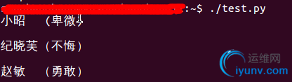

f = open('test.txt')
for line in f:
print line
