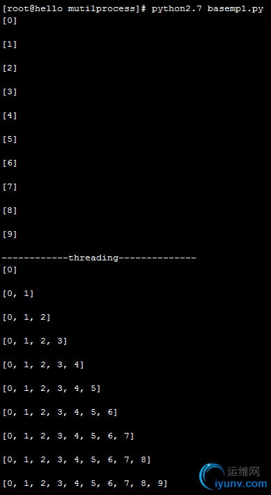

在一般情况下多个进程的内存资源是相互独立的,而多线程可以共享同一个进程中的内存资源,示例代码:
9
10
11
12
13
14
15
16
17
18
19
20
21
22
23
24
25
26
27
28
29
#!/usr/local/python27/bin/python2.7
# coding=utf8
# noinspection PyUnresolvedReferences
# 通过多进程和多线程对比,进程间内存无法共享,线程间的内存共享
from multiprocessing import Process
import threading
import time
lock = threading.Lock()
def run(info_list,n):
    lock.acquire()
    info_list.append(n)
    lock.release()
    print('%s\n' % info_list)
info = []
for i in range(10):
'''target为子进程执行的函数,args为需要给函数传递的参数'''
    p = Process(target=run,args=[info,i])
    p.start()
'''这里是为了输出整齐让主进程的执行等一下子进程'''
time.sleep(1)
print('------------threading--------------')
for i in range(10):
    p = threading.Thread(target=run,args=[info,i])
    p.start()
执行结果:

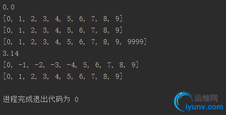

# coding=utf8
# 通过Value Array 实现进程间的内存共享
from multiprocessing import Value,Array,Process
def f(n,a,raw):
    n.value = 3.14
    for i in range(5):
        a = -a
    raw.append(9999)
    print(raw)
if __name__ == '__main__':
    num = Value('d',0.0)
    arr = Array('i',range(10))
    raw_list = range(10)
    print(num.value)
    print(arr[:])
    print(raw_list)
#调用子进程之后,重新打印array和value,值将会发生改变。 而raw_list 普通列表在外层打印则没有发生改变。
    p = Process(target=f,args=(num,arr,raw_list))
    p.start()
    p.join()
    print(num.value)
    print(arr[:])
    print(raw_list)
执行结果:

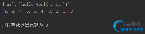

# coding=utf8
from multiprocessing import Process,Manager
def f(d,l):
    d[1] = '1'
    d['aa'] = 'hello World'
    l.reverse()
    manager = Manager()
    d = manager.dict()
    l = manager.list(range(10))
    p = Process(target=f,args=(d,l))
    p.start()
    p.join()
    print(d)
    print(l)
执行结果:

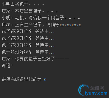

# coding=utf8
import threading
import time
def producer():
    print ('店家:本店出售包子。。。。')
    '''触发事务等待'''
    event.wait()
    '''清楚事务状态'''
    event.clear()
    print ('小明:老板,请给我一个肉包子。。。。')
    print ('店家:正在生产包子,请稍等xxxxxxxxx')
    time.sleep(6)
    print ('店家:你要的包子已经好了------')
    event.set()
def consumer():
    print('小明去买包子。。。。')
    '''解除事务等待'''
    event.set()
    time.sleep(2)
    while True:
        if event.isSet():
            print ('谢谢!')
            break
        else:
            print ('包子还没好吗? 等待中...')
            time.sleep(1)
event = threading.Event()
p = threading.Thread(target=producer)
c = threading.Thread(target=consumer)
c.start()
p.start()
执行结果:
