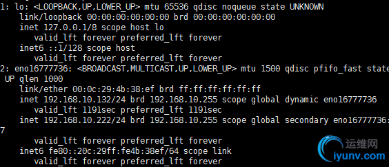

查看资源是否生效
# ip addr

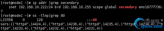

七、配置httpd并测试
①安装
# yum install httpd
# ssh node2 -- yum install httpd
②配置index.html
node1:
# echo "<h1>Web in node1<h1>">> /var/www/html/index.html
node2:
# echo "<h1>Web in node2<h1>">> /var/www/html/index.html
