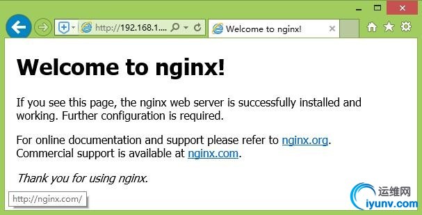

启动nginx
[iyunv@www nginx-1.9.6]# nginx
[iyunv@www nginx-1.9.6]# netstat -tlnp |grep nginx
tcp        0      0 0.0.0.0:80                  0.0.0.0:*                   LISTEN      4554/nginx

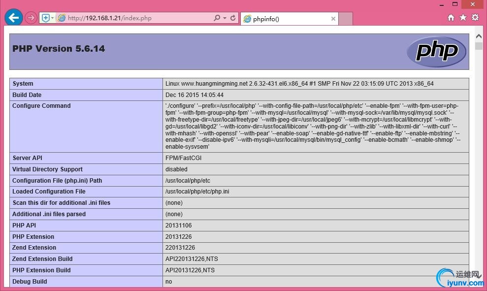

8、配置nginx服务器php解析
[iyunv@www nginx-1.9.6]# vim /etc/nginx/nginx.conf
打开php配置:
65         location ~ \.php$ {
66             root           html;
67             fastcgi_pass   127.0.0.1:9000;
68             fastcgi_index  index.php;
69             fastcgi_param  SCRIPT_FILENAME  /usr/local/nginx/html$fastcgi_script_name;
70             include        fastcgi_params;
71         }
user  nginx;
worker_processes  8;
error_log  /var/log/nginx/error.log;
pid        /var/run/nginx.pid;
events {
    worker_connections  204800;
    log_format  main  '$remote_addr - $remote_user [$time_local] "$request" '
                      '$status $body_bytes_sent "$http_referer" '
                      '"$http_user_agent" "$http_x_forwarded_for"';
    access_log  /var/log/nginx/access.log  main;
    sendfile        on;
    tcp_nopush     on;
    charset utf-8;
php-fpm启动报错
Starting php-fpm [18-Dec-2015 13:33:03] ERROR: unable to bind listening socket for address '127.0.0.1:9000': Address already in use (98)
[18-Dec-2015 13:33:03] ERROR: FPM initialization failed
failed
[iyunv@www nginx-1.9.6]# /usr/local/php/sbin/php-fpm -t
[18-Dec-2015 13:35:14] NOTICE: configuration file /usr/local/php/etc/php-fpm.conf test is successful
[iyunv@www nginx-1.9.6]# killall php-fpm
[iyunv@www nginx-1.9.6]# service php-fpm start
Starting php-fpm  done
重新加载配置
[iyunv@www nginx-1.9.6]# nginx -t
nginx: the configuration file /etc/nginx/nginx.conf syntax is ok
nginx: configuration file /etc/nginx/nginx.conf test is successful
[iyunv@www nginx-1.9.6]# nginx -s reload
测试php解析
[iyunv@www nginx-1.9.6]# vim /usr/local/nginx/html/index.php
