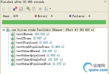

  十.测试
  运行上面的代码,进行测试,其结果如下:
Simple SET: 5.227 seconds
Transaction SET: 0.5 seconds
Pipelined SET: 0.353 seconds
Pipelined transaction: 0.509 seconds
Simple@Sharing SET: 5.289 seconds
Pipelined@Sharing SET: 0.348 seconds
Simple@Pool SET: 5.039 seconds
Pipelined@Pool SET: 0.401 seconds
  另外,经测试分布式中用到的机器越多,调用会越慢。上面是2片,下面是5片:
Simple@Sharing SET: 5.494 seconds
Pipelined@Sharing SET: 0.51 seconds
Simple@Pool SET: 5.223 seconds
Pipelined@Pool SET: 0.518 seconds
  下面是10片:
Simple@Sharing SET: 5.9 seconds
Pipelined@Sharing SET: 0.794 seconds
Simple@Pool SET: 5.624 seconds
Pipelined@Pool SET: 0.762 seconds
  下面是100片:
Simple@Sharing SET: 14.055 seconds
Pipelined@Sharing SET: 8.185 seconds
Simple@Pool SET: 13.29 seconds
Pipelined@Pool SET: 7.767 seconds
  分布式中,连接池方式调用不但线程安全外,根据上面的测试数据,也可以看出连接池比直连的效率更好。
  十一.完整的测试代码
package com.bijian.study;

+ " seconds");
  运行结果:
Simple SET: 24.316 seconds
Transaction SET: 2.641 seconds
Pipelined SET: 1.016 seconds
Pipelined transaction: 1.484 seconds
Simple@Sharing SET: 29.287 seconds
Pipelined@Sharing SET: 1.953 seconds
Simple@Pool SET: 31.537 seconds
Pipelined@Pool SET: 1.156 seconds
  直接查看redis数据库:
[iyunv@localhost bin]# /usr/local/redis/bin/redis-cli
127.0.0.1:6379> dbsize
(integer) 800000
127.0.0.1:6379>
  PS:如上实例是基于jedis-2.1.0.jar、commons-pool-1.6.jar、junit-4.11.jar、hamcrest-core-1.3.jar运行的。
