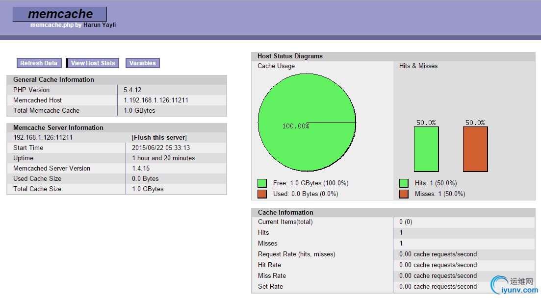

cp memcache.php /usr/local/lnmp/nginx/html/
vim /usr/local/lnmp/nginx/html/memcache.php
define('ADMIN_USERNAME','admin');       // Admin Username
define('ADMIN_PASSWORD','westos');      // Admin Password
$MEMCACHE_SERVERS[] = '192.168.1.126:11211'; // add more as an array
在浏览器输入:http://192.168.1.126/memcache.php 然后输入用户名密码登陆
