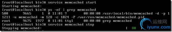

  6. 启动memcached服务,并检查memcached是否启动,并关闭memcached:
  service memcached start
ps –ef | grep memcached
service memcached stop
如下截图所示:
