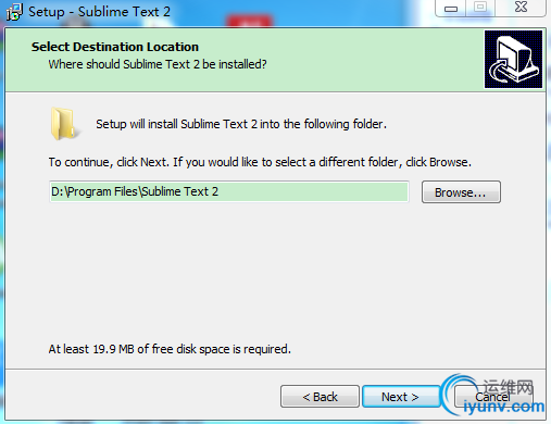

  First search and download sublime text, then install the software.
  Just do as instruction, you can easily finish the installation.

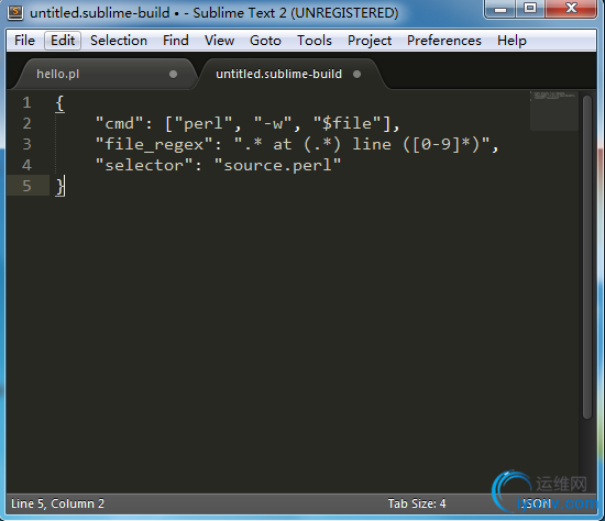

  The installation is finished. Now you can write your perl codes by sublime. Note that the suffix of the file must be ".pl" or ".pm". However, you can not run your codes. To implement this function, you should move one more step.
  Open sublime text, you'll find option "Tools" in the toolbar. Click Tools->Build System->new Build System.
  Then copy these codes into the new dialog box.
"cmd": ["perl", "-w", "$file"],
"file_regex": ".* at (.*) line ([0-9]*)",
"selector": "source.perl"
  Then press Ctrl+S ,save the file with the name of "Perl.sublime-build" into the default directory. Done.
  Now your sublime text is able to run perl. (use Ctrl+B)
