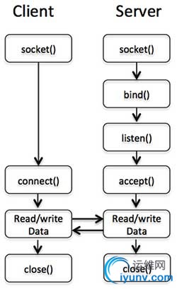

  http://www.tutorialspoint.com/perl/perl_socket_programming.htm
  To explain above mentioned socket concept we will take an example of Client - Server Programming using Perl.
  To complete a client server architecture we would have to go through the following steps:
To create a server
  •   Create a socket using socket call.
  •   Bind the socket to a port address using bind call.
  •   Listen to the socket at the port address using listen call.
  •   Accept client connections using accept call.
To create a client
  •   Create a socket with socket call.
  •   Connect (the socket) to the server using connect call.
  Following diagram shows complete sequence of the calls used by Client and Server to communicate with each other:
