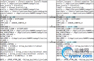

  edit3: If, for some unknown reason, you still don’t get the correct architecture, you can manually edit the Makefile and fix the compile flags yourself. The screenshot shows the only 3 differences in resulting Makefile if I ran the ./configure command without (64-bit, left) and with (32-bit, right) the FLAGS settings:
  Just open the Makefile in your favorite text editor and adjust the flags directly.
