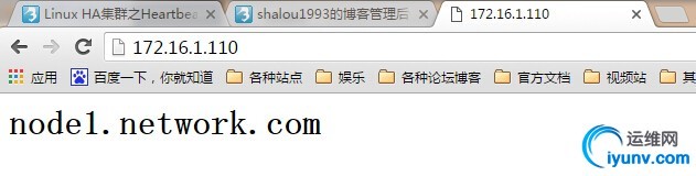

6、配置httpd服务,测试没问题之后再禁止其开机自启动
node1
[iyunv@node1 ha.d]# echo "<h1>node1.network.com</h1>" > /var/www/html/index.html
[iyunv@node1 ha.d]# service httpd start
Starting httpd:                                            [  OK  ]
[iyunv@node1 ha.d]# curl http://172.16.1.103
[iyunv@node1 ha.d]# service httpd stop
Stopping httpd:                                            [  OK  ]
[iyunv@node1 ha.d]# chkconfig httpd off
node2
[iyunv@node2 ha.d]# echo "<h1>node2.network.com</h1>" > /var/www/html/index.html
[iyunv@node2 ha.d]# service httpd start

此时模拟node1节点故障,看资源是否会转移至node2节点
[iyunv@node1 ha.d]# /usr/share/heartbeat/hb_standby
Going standby [all].
此时可以看到资源已成功从node1转移至node2,此时再让node1上线
[iyunv@node1 ha.d]# /usr/share/heartbeat/hb_takeover
因为我们在主配置文件中定义了auto_failback on,所以会实现故障转回功能,若不想自动转回,则设置此参数为off即可
