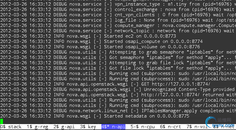

At this point, you have a fully functioning OpenStack RC1 environment. You can do the following to check into the logs (actually just the daemon output in a screen window):
$> screen -x
Switch screen windows using the<Ctrl>-a NUMkey combination, whereNUMis the number of the screen window you see at the bottom of your console. Type<Ctrl>-a
dto detach from your screen session. The screenshot below shows what your screen session may look like. In the screenshot, I’ve hit<Ctrl>-a 4to switch to then-apiscreen
window which is showing the Nova API server daemon output.
screen session showing the Nova API server window...
