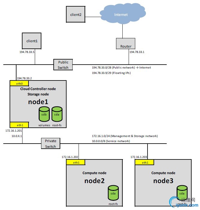

服务器规划:
控制节点:eth0 : 10.10.128.11  ,  eth2: 10.10.64.11
计算节点:eth2 : 10.10.128.12  ,  eth4:10.10.64.12
计算节点:eth2 : 10.10.128.13  ,  eth4:10.10.64.13
网段规划:
公网:163.167.28.70
内网:10.10.128.0/24
私网:10.10.64.0/24
虚拟机网段:10.11.11.0/24
操作系统:
Linux:ubuntu-12.04.1-server-amd64
服务:
root@ubuntu-11:~# nova-manage service list
Binary           Host                                 Zone             Status     State Updated_At
nova-scheduler   ubuntu-11                            nova             enabled    :-)   2012-11-20 03:54:48
nova-consoleauth ubuntu-11                            nova             enabled    :-)   2012-11-20 03:54:47
nova-compute     ubuntu-13                            nova             enabled    :-)   2012-11-20 03:54:50
nova-network     ubuntu-13                            nova             enabled    :-)   2012-11-20 03:54:43
nova-cert        ubuntu-11                            nova             enabled    :-)   2012-11-20 03:54:46
nova-compute     ubuntu-12                            nova             enabled    :-)   2012-11-20 03:54:43
nova-network     ubuntu-12                            nova             enabled    :-)   2012-11-20 03:54:50

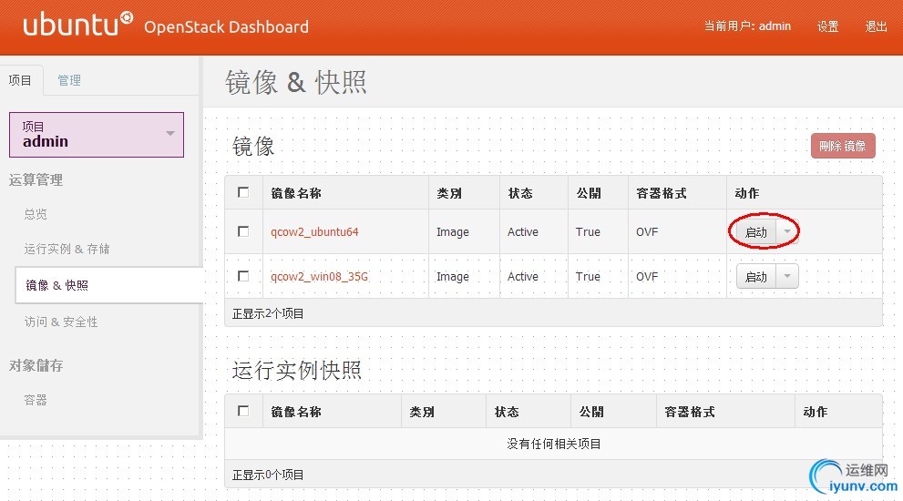

1、上传镜像
glance add name="qcow2_win08_35G" is_public=true container_format=ovf disk_format=qcow2 < qcow2_win08_35G.img
glance add name="qcow2_ubuntu64" is_public=true container_format=ovf disk_format=qcow2 < qcow2_ubuntu64.img

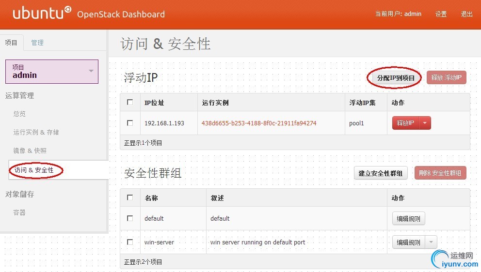

3、安全组(防火墙规则)
nova secgroup-add-rule default tcp 1 65535 0.0.0.0/0
nova secgroup-add-rule default udp 1 65535 0.0.0.0/0
nova secgroup-add-rule default icmp -1 -1 0.0.0.0/0
Create the win-server security group to allow ping (icmp), ssh (tcp/22), and http (tcp/80) from everywhere (0.0.0.0/0):
nova secgroup-create win-server "win server running on default port"
nova secgroup-add-rule win-server icmp -1 -1 0.0.0.0/0
nova secgroup-add-rule win-server tcp 22 22 0.0.0.0/0
nova secgroup-add-rule win-server tcp 3389 3389 0.0.0.0/0
nova secgroup-add-rule win-server tcp 80 80 0.0.0.0/0
nova secgroup-add-rule win-server tcp 20 20 0.0.0.0/0
nova secgroup-add-rule win-server tcp 21 21 0.0.0.0/0

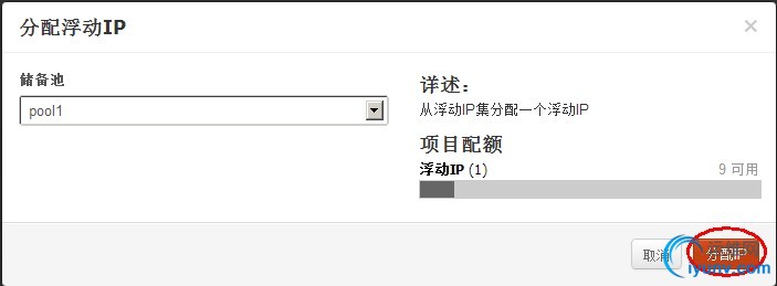

4、创建浮动IP
nova-manage floating create --pool=pool1 --ip_range=10.10.128.192/26

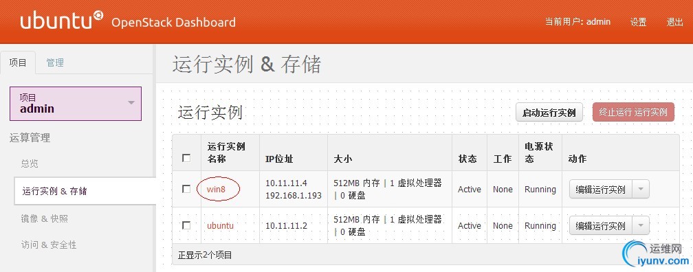

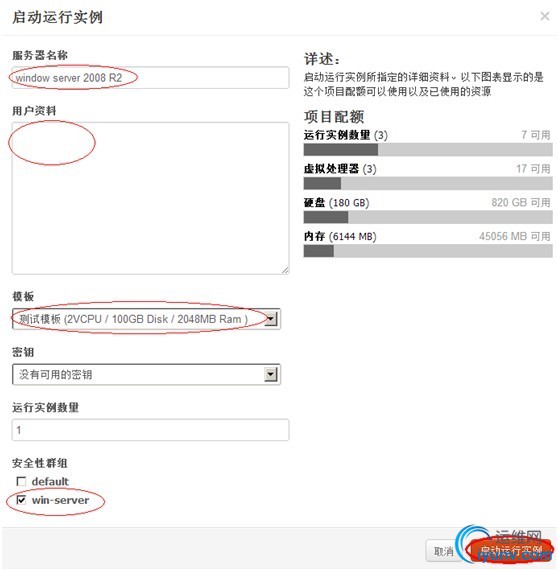

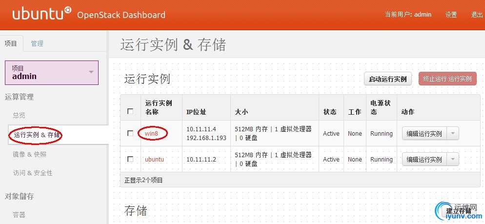

5、使用镜像创建实例(虚拟机)

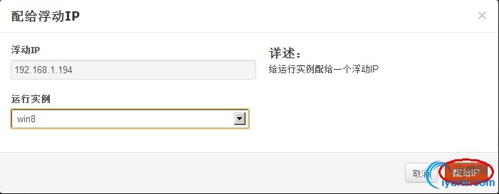

6、绑定浮动IP

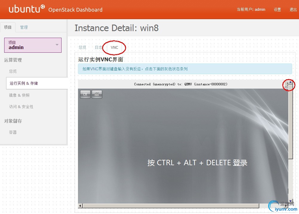

7、登录到虚拟机
8、VNC控制台
