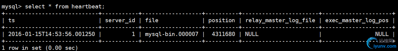

1,首先添加heartbeat表
mysql> create database heartbeat;
Query OK, 1 row affected (0.00 sec)
[iyunv@mysql-master data]#pt-heartbeat --user=root --password=123456
-S /tmp/mysql.sock -D heartbeat  --master-server-id=1  --create-table --update
