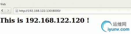

打开浏览器进行查看:

已成功切换,在打开浏览器:
   实验二:重新启动120,查看下虚拟ip130是否切换过来:

查看下浏览器:
已正常切换

#keepalived -S 0
local0.*  /etc/keepalived/keepalived.log
3,重启日志文件:
9
[iyunv@hadoop1 sysconfig]# /etc/init.d/rsyslog restart
Shutting down system logger:                               [  OK  ]
Starting system logger:                                    [  OK  ]
[iyunv@hadoop1 sysconfig]# /etc/init.d/keepalived restart
Stopping keepalived:                                       [  OK  ]
Starting keepalived:
[iyunv@hadoop1 keepalived]# tail -f /etc/keepalived/keepalived.log
Jan 15 17:37:27 hadoop1 Keepalived_vrrp[2008]: VRRP_Instance(VI_1) Received lower prio advert, forcing new election
Jan 15 17:37:27 hadoop1 Keepalived_vrrp[2008]: VRRP_Instance(VI_1) Sending gratuitous ARPs on eth0 for 192.168.122.130
日志正常输出。
