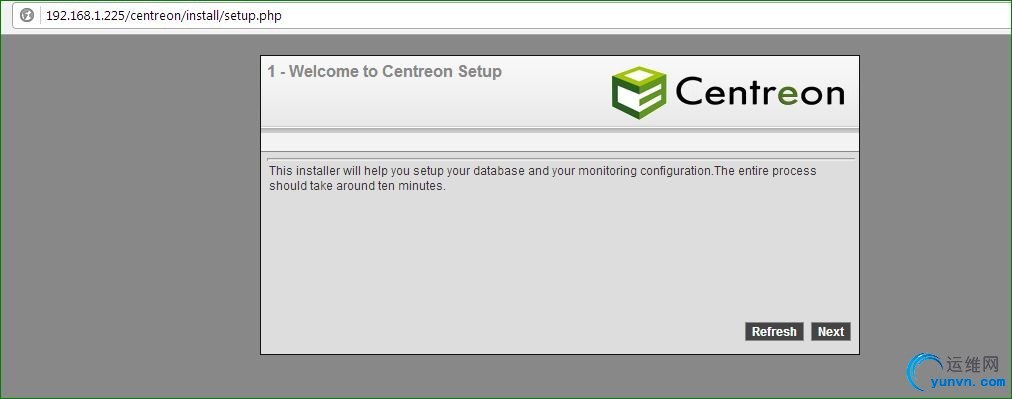

[iyunv@jk centreon-2.5.0]# ./install.sh -i

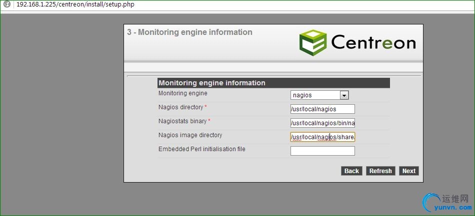

        Start CentWeb Installation
Where is your Centreon directory?
default to [/usr/local/centreon]
Do you want me to create this directory ? [/usr/local/centreon]
[y/n], default to [n]:
> y
Path /usr/local/centreon                                   OK
Where is your Centreon log directory
default to [/usr/local/centreon/log]
Do you want me to create this directory ? [/usr/local/centreon/log]
> y
Path /usr/local/centreon/log                               OK
Where is your Centreon etc directory
default to [/etc/centreon]
Do you want me to create this directory ? [/etc/centreon]
> y
Path /etc/centreon                                         OK
Where is your Centreon binaries directory
default to [/usr/local/centreon/bin]
Do you want me to create this directory ? [/usr/local/centreon/bin]
> y
Path /usr/local/centreon/bin                               OK
Where is your Centreon data informations directory
default to [/usr/local/centreon/data]
Do you want me to create this directory ? [/usr/local/centreon/data]
> y
Path /usr/local/centreon/data                              OK
Where is your Centreon variable library directory?
default to [/var/lib/centreon]
Do you want me to create this directory ? [/var/lib/centreon]
> y
Path /var/lib/centreon                                     OK
/usr/bin/rrdtool                                           OK
/bin/mail                                                  OK
/usr/bin/php                                               OK
Where is PEAR [PEAR.php]
default to [/usr/share/php/PEAR.php]
> /usr/share/pear/PEAR.php
Path /usr/share/pear                                       OK
/usr/bin/perl                                              OK
Finding Apache user :                                      apache
Finding Apache group :                                     apache
What is the Centreon group ? [centreon]
default to [centreon]
Do you want me to create this group ? [centreon]
> y
What is the Centreon user ? [centreon]
Do you want me to create this user ? [centreon]
> y
What is the Monitoring engine user ?
> nagios
What is the Broker user ? (optional)
> nagios
What is the Monitoring engine log directory ?
> /usr/local/nagios/var/log
Where is your monitoring plugins (libexec) directory ?
default to [/usr/lib/nagios/plugins]
> /usr/local/nagios/libexec
Path /usr/local/nagios/libexec                             OK
Add group centreon to user apache                          OK
Add group centreon to user nagios                          OK
Add group nagios to user apache                            OK
Add group nagios to user centreon                          OK
        Configure Sudo
Where is sudo configuration file
default to [/etc/sudoers]
/etc/sudoers                                               OK
What is the Monitoring engine init.d script ?
> /etc/init.d/nagios
What is the Monitoring engine binary ?
> /usr/local/nagios/bin/nagios
What is the Monitoring engine configuration directory ?
> /usr/local/nagios/etc
Where is the configuration directory for broker module ?
Where is the init script for broker module daemon ?
> /etc/init.d/ndo2db
Your sudo is not configured
Do you want me to configure your sudo ? (WARNING)
> y
Configuring Sudo                                           OK
        Configure Apache server
Do you want to add Centreon Apache sub configuration file ?
> y
Create '/etc/httpd/conf.d/centreon.conf'                   OK
Configuring Apache                                         OK
Do you want to reload your Apache ?
> y
Reloading Apache service                                   FAIL
Preparing Centreon temporary files
Change right on /usr/local/centreon/log                    OK
Change right on /etc/centreon                              OK
Change macros for insertBaseConf.sql                       OK
Change macros for sql update files                         OK
Change macros for php files                                OK
Change macros for perl binary                              OK
Change right on /usr/local/nagios/etc                      OK

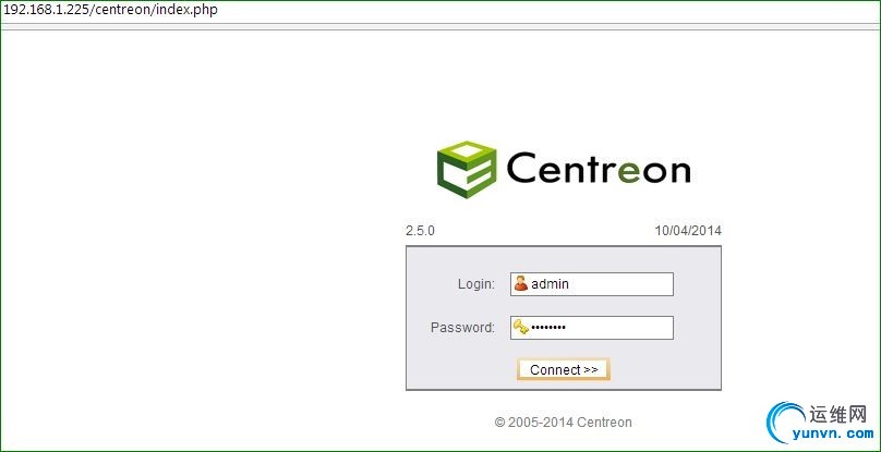

这个步骤完成后,我们进行网页端安装
http://192.168.1.225/centreon 打开安装程序
如图:
填写正确的路径
填写管理员密码和邮箱
填写数据库用户名和密码
wKioL1NGXTqBmEa-AAD4zYYLLEk286.jpg 遇到下面这个错误

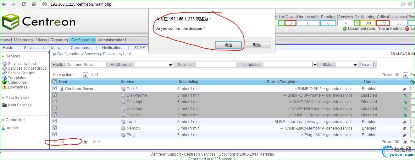

先把默认服务删除

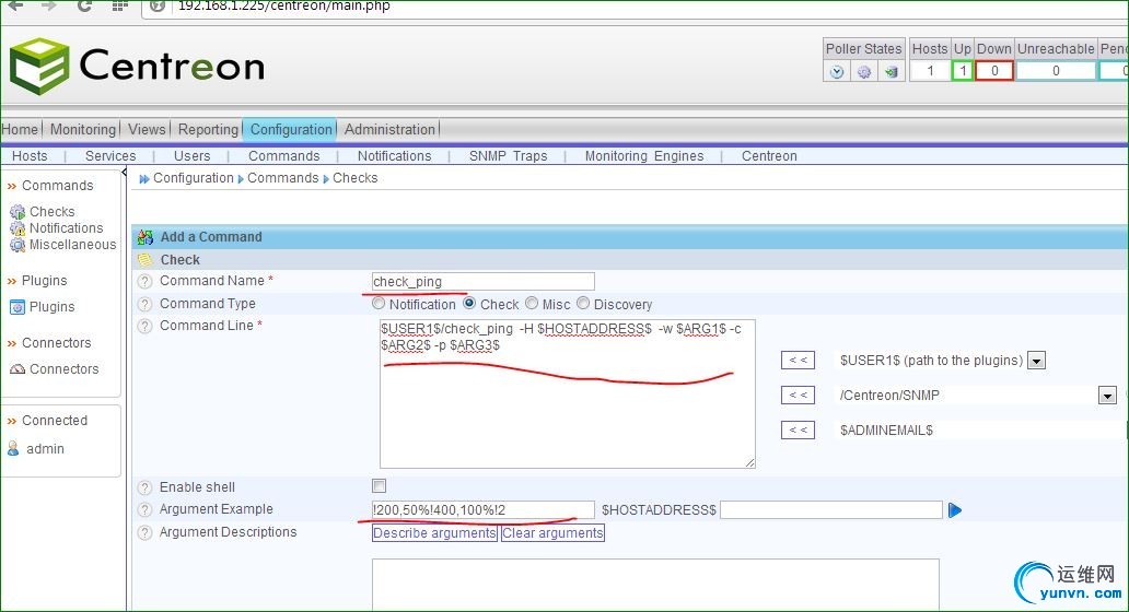

添加一个check_ping命令
$USER1$/check_ping  -H $HOSTADDRESS$  -w $ARG1$ -c $ARG2$ -p $ARG3$
Configuration->Commands->Add

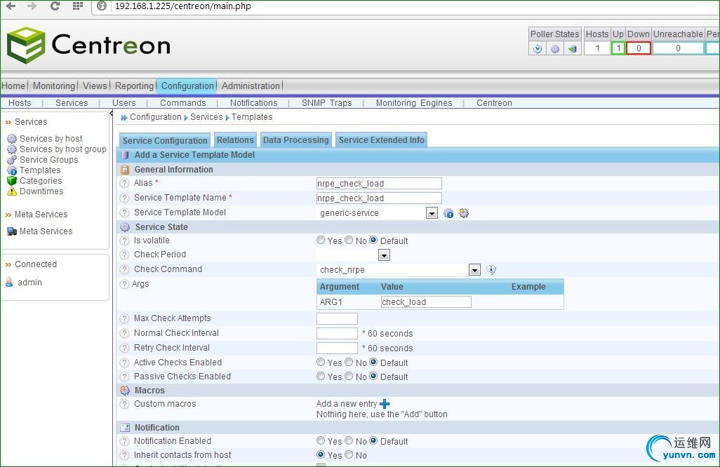

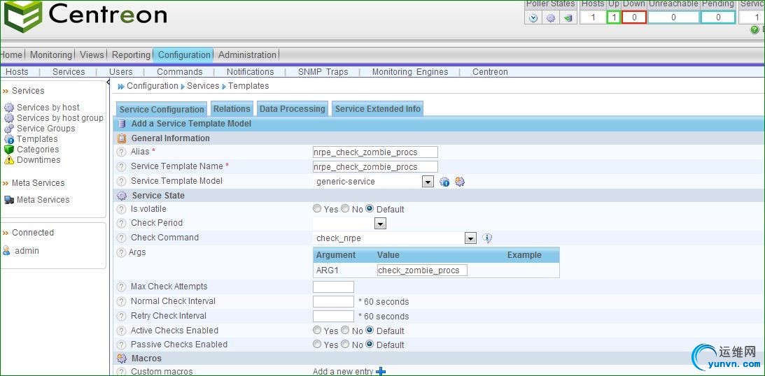

接着添加一个服务模板
Configuration->Services-Templates->Add
检查是否正确并生成配置:管理-》nagios 勾选所有动作-》导出

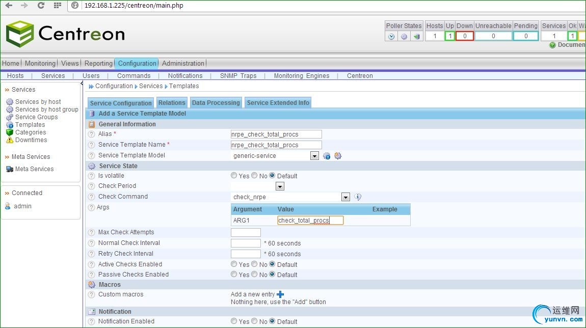

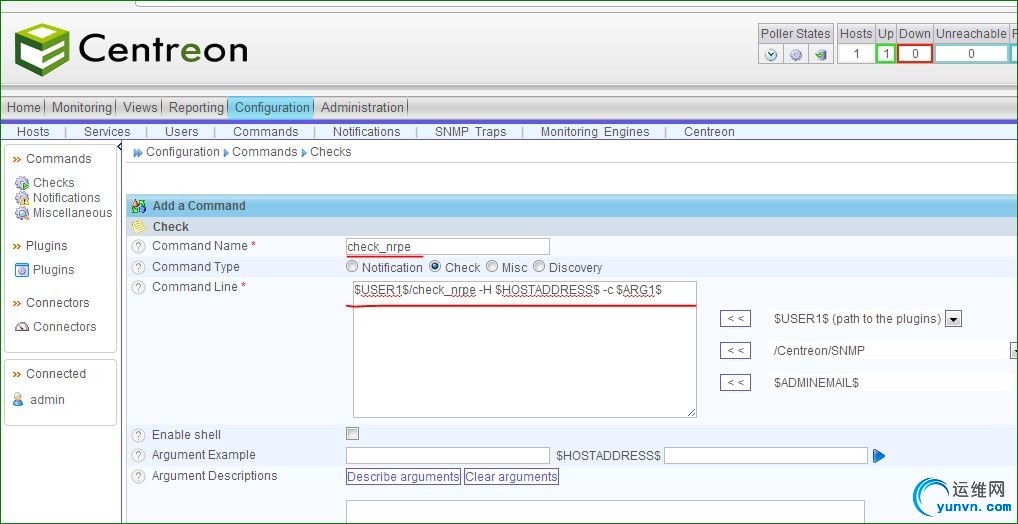

再添加一个命令check_nrpe ,Configuration->Commands->Add
$USER1$/check_nrpe -H $HOSTADDRESS$ -c $ARG1$
下面添加服务
配置-》服务-》模板-》增加
添加check_load

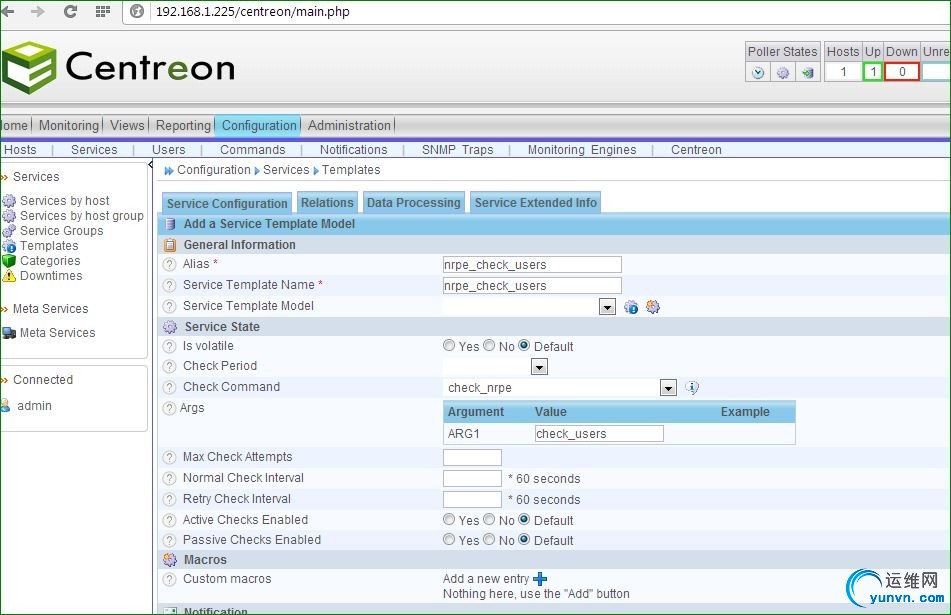

添加check_users
添加check_ disk
添加check_zombie_procs
添加check_total_procs

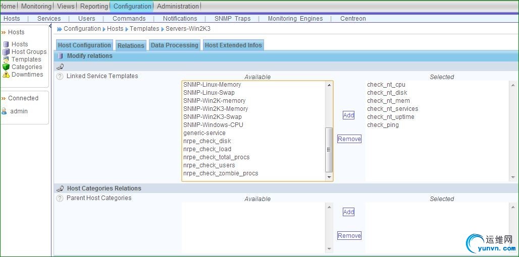

关联模板:因为 Centreon-Server继承的是Servers-Linux主机模板,所以我们在Servers-Linux模板里将刚才的服务模板都关联上

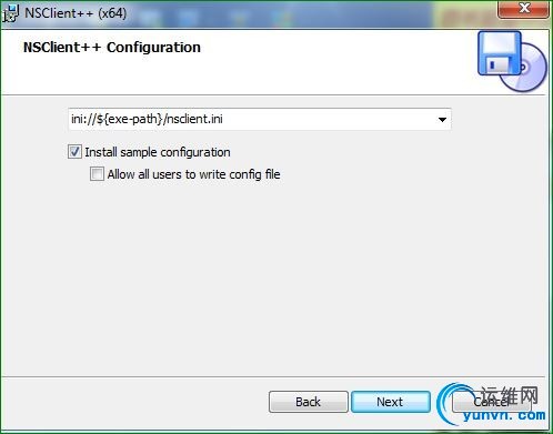

下面说说nrpe监控WINDOWS
首先现在NRPE客户端 下载地址如下:
http://nsclient.org/nscp/downloads
在这里我们下载的是NSCP-0.4.2.88-x64.msi
然后安装这个软件

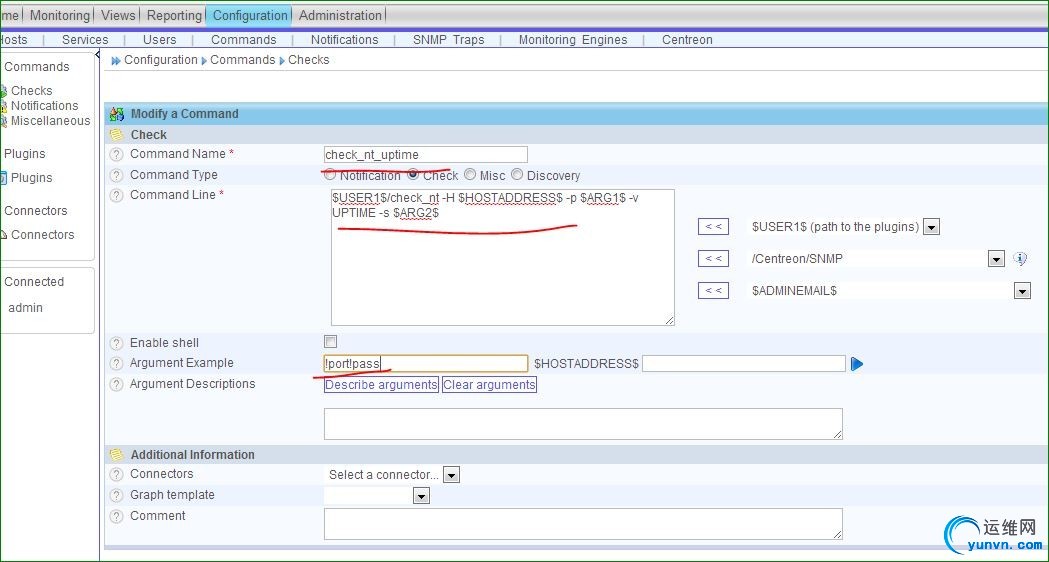

添加一个check_nt_uptime命令
$USER1$/check_nt -H $HOSTADDRESS$ -p $ARG1$ -v UPTIME -s $ARG2$

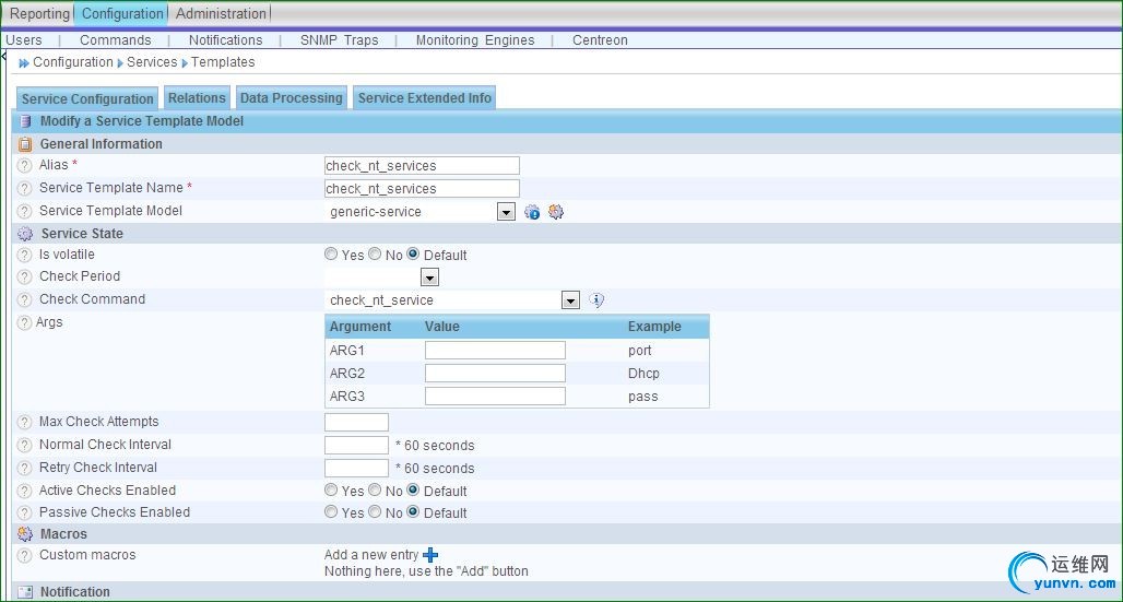

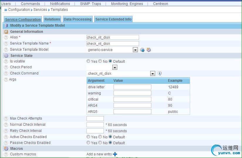

添加完成后我们依次添加服务模板
添加check_nt_cpu
添加check_nt_disk
添加check_nt_mem
添加check_nt_uptime
添加check_nt_services
添加完成后我们添加一台WINDOWS主机
添加完成后我们关联模板

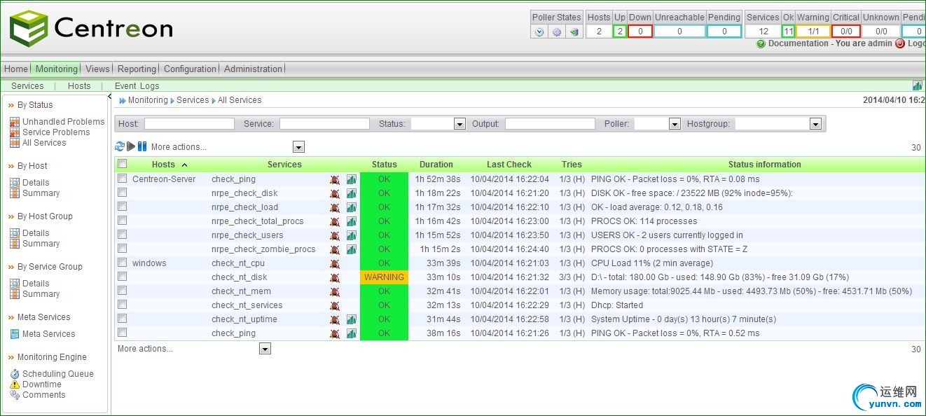

过一会儿如下:

安装centreon完成后配置的时候
第一步加个check_ping的命令
但接下来我就遇到问题了
在加服务模版的时候args这里没有参数的框?
是我哪里操作不多吗
我这次是按这个的步骤来的 ,上次下载了cnyunwei V11版的centreon也这样
搞不懂了  求大神们帮助啊
